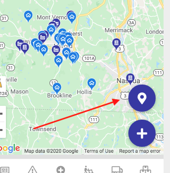

I’m having an issue with the Map feature.
I thought I had locked the ability for my drivers to add a new entry on the app but I found out there is actually another way to do this through the map view. As you can see in the photos below, when the driver uses the pin marker on the map, this bottom comes up which allow him to add a new entry.
I am trying to find the hide action that is causing it but I have had no success. How can I get rid of this action?
Thanks for your help

On a map where data has Add capability, you are presented the Pin icon indicated in the first image below.
Tapping the icon gives you a bouncing pin on the map that you can drag to a location.
Once dropped, it identifies the address AND provided you the “Check Mark” icon shown above and in the second image below. It is this “Check Mark” icon that @Alejandra_Petro is trying to get access to hide.
Tapping the “Check Mark” icon will open an input Form view for the datasource with the Address column pre-filled by the address from the dropped pin.
Tap “Pin” icon to be able to select an address on the map
Tap “Check Mark” icon to capture address and pre-fill input Form
Input Form with address populated automatically
