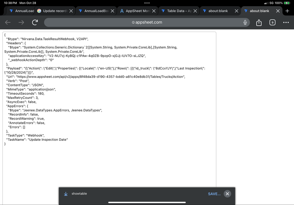

Creating webhook to update the columns from one app to another app
I need to update the the columns from one app to another app.
In the annualloadbook app I need to update the, Table {Trucks} Column [Last Inspection]
From the inspection app Table {Equipment} Column [Last Inspection]
"Action": "Add",
"Properties": {
"Locale": "en-US",
"Rows": {
"id_truck": "<<[ID]>>",
"Last Inspection": "<<[Last Inspection]>>"}
Iโ€™m getting an error and Iโ€™m unable to see whatโ€™s wrong if anyone can spot it please

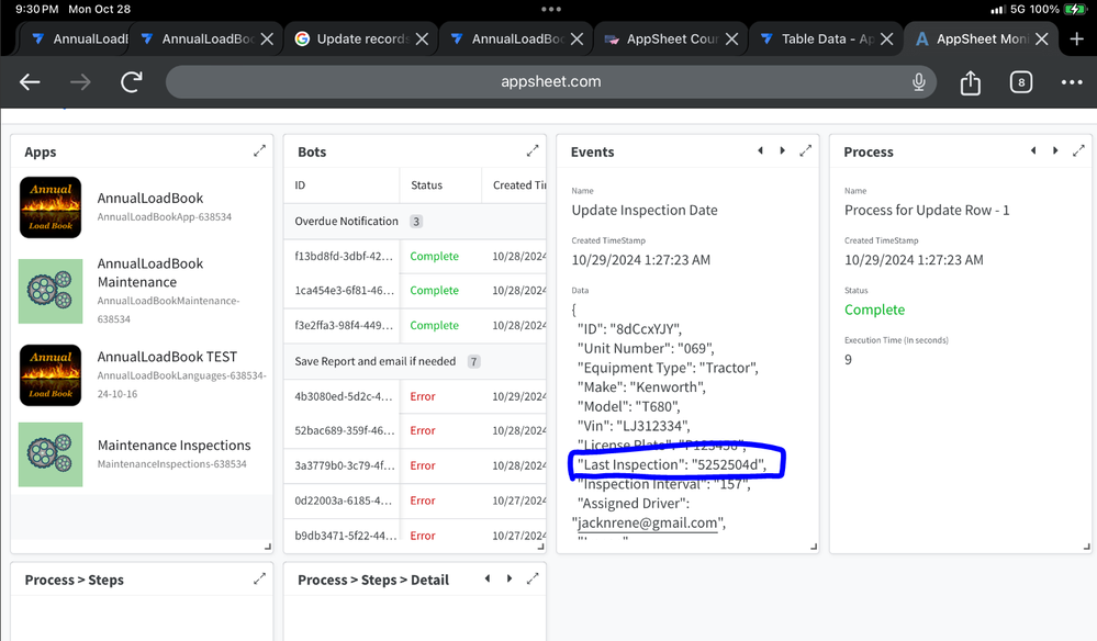

Iโ€™m still getting the error I donโ€™t quite understand
I tried to make it come from the Inspection table Virtual column [Vehicle Inspection Date] that is where the table Equipment column [Last Inspection] gets the date from
I just need to update the date in table Trucks [Last Inspection]
Am I missing something?
  • Error 1 : Failed to parse JSON due to Invalid property identifier character: [. Path 'Rows', line 1, position 61.. Invalid JSON value starts with: ["id_truck": "e594058b","Last Inspection": "f093af0a"]}}
"Action": "Add",
"Properties": {
"Locale": "en-US",
"Rows": {

At looking at the documentation, brackets are being reversed, and one comma must be removed after the "locale" part.
Can you try this:
"Action": "Edit",
"Properties": {
"Locale": "en-US"
"Rows": [
I changed the Action to Edit and still have the same error
I noticed the ApplicationAccessKey was missing is disappeared after I edited the action and saved it
HTTP Headers
Optional HTTP headers. (Expressions that yield HTTP header names or values are supported.)
Every time I edit it here and put the access key back in and save it disappears
In the error that is the right [ID] for the Truck and that is the right date for the Inspection date
Replaced brackets and removed the coma after โ€œLocaleโ€
It tested OK
Thank you Ill test it to see if the data is moving

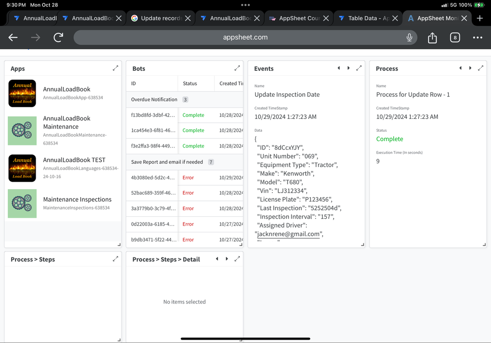

After testing it says in the monitor that it was a success but the data in the destination [Last Inspection] didnโ€™t change
The Column [Last Inspection] should have updated to 10/28/2024
As of the last few tests Iโ€™m not getting any errors and on execute it says success
But its still not changing the Last Inspection Date in the destination column
It looks correct you can see the Truck [ID] matches and the [Last Inspection] date is correct 10/28/2024
But it did not change the date in the destination column [Last Inspection] Type Date

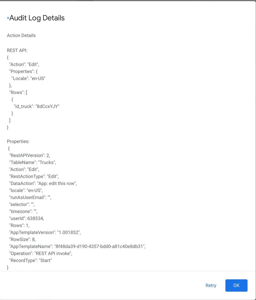

We need to see the audit log of the App the request was sent to.  It is that App where the proper error messages for why it couldn't carry out the request will be displayed...
Scott Thank you I didnโ€™t know to look there.

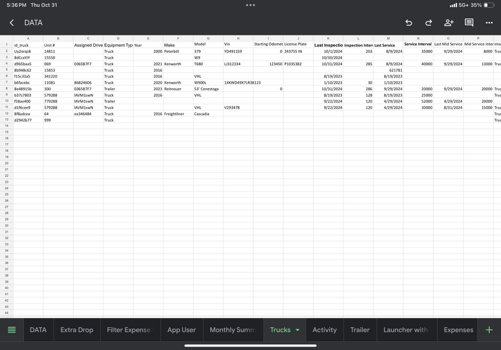

It looks to me that it is only looking at the Key column [id_truck] which doesnโ€™t need to be edited as the id_truck in the destination app is the same ID in the host app.
Itโ€™s the [Last Inspection] column that needs to update and I donโ€™t see it included her in the log
Log for destination appLog for destination app

I'm going off on a tangent here because I don't understand the data from one of your screen shots..  You have said that Last Inspection should be a Date and you show the screenshot of the sheet with a bunch of dates in that column.  However, when you look at the Automation Monitor ouput, you can see that Last Inspection seems to have a UNIQUEID() assigned to it?
Yes sir it does. In the maintenance app for the column [Last Inspection] is a type ref to table inspections virtual column [Vehicle inspection date] it puts the short date in the column [Last Inspection] in table Equipment.
However I changed the API to this and it pulls the creation date which is the same as I need to change the Table trucks in annualloadbook app column[Last Inspection]
"Action": "Edit",
"Properties": {
"Locale": "en-US"
"Rows": [
"Last Inspection": "<<[Created Date]>>"
It is still sending the API request from host app in email account jacknrene
But is receiving the request in destination app annualloadbook email
When the equipment belongs to jacknrene on both apps?
Please look at the audit logs below
Host log for current APIHost log for current APII do see something wrong. I reran the API by doing another inspection in host app Iโ€™m signed in both app using the same email.
The API was a success and it does now include both the [id_truck] Key column and the edit column [Last Inspection]
What I am noticing and iโ€™m not sure but the host app sends API under the jacknrene email
The destination app receives under the annualloadbook email
Look at the image for the latest API callAPI SUCCESSAPI SUCCESSWrong emailWrong email
It looks like its sending under one email account and receiving under the owner email account

I posted the audit log for the destination app
it is show only the id_truck key column not the [Last Inspection] date

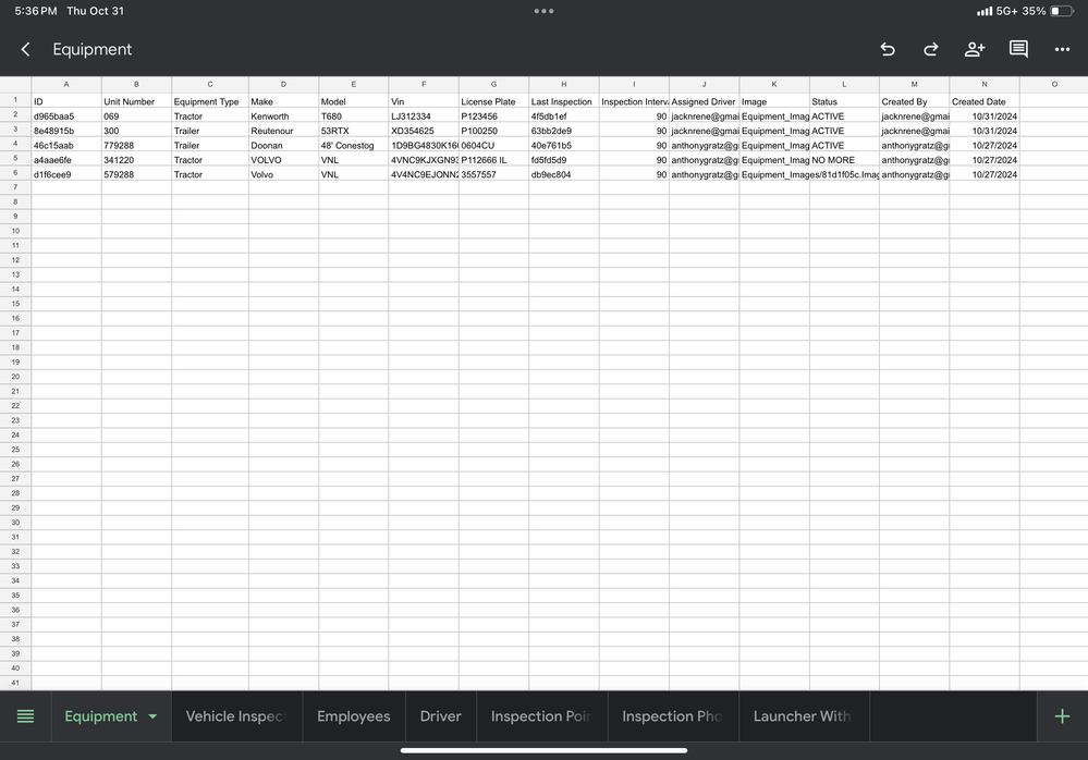

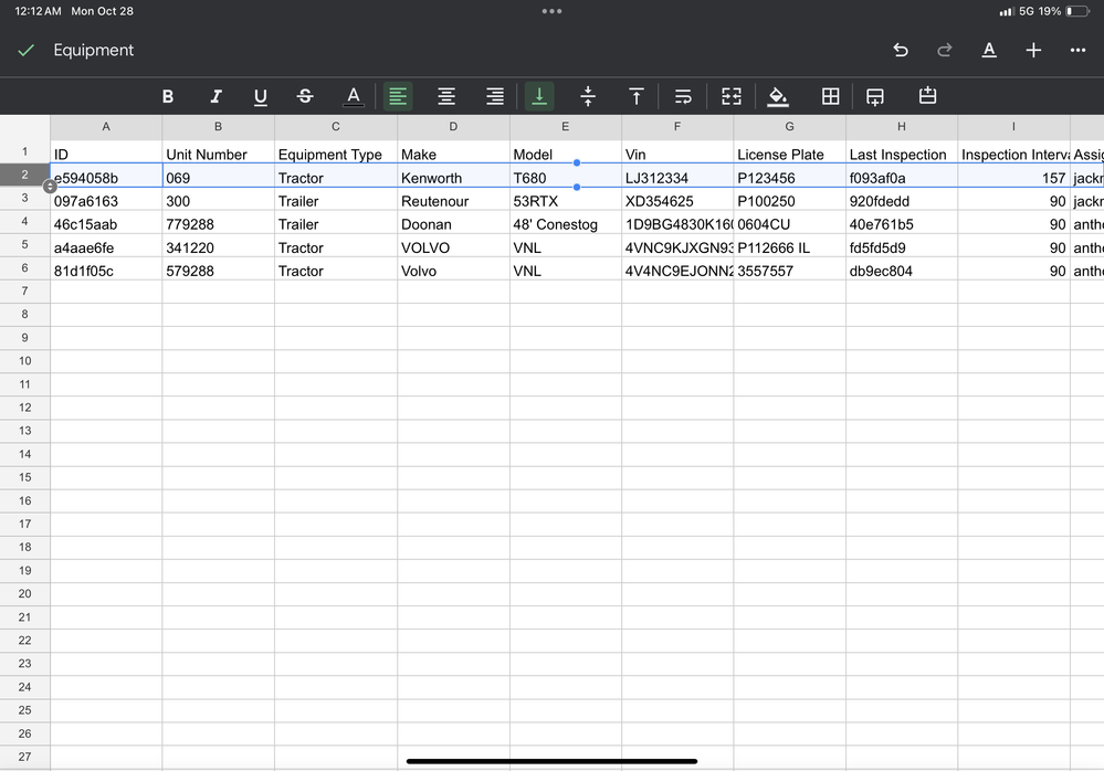

Thank you Scott I reread what you wrote a couple of times and it dawned on me what the issue was.
The Key column values were not the same in the Inspection app table equipment [ID]
And the annualloadbook app Table Trucks [id_truck]
So i changed the Key columns so both values match.
The Bot Is working and changing the Dates of last inspection so the match. Now I can make the rest of the data work also.
