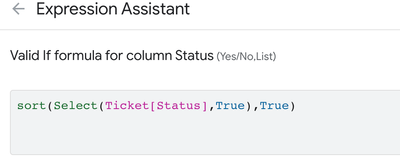

for point 2 I tried to use "sort(Select(Ticket[Status],True),True)" expression under Data validity where I tried to sort the field value in descending order which will helps me to resolve my issue. but I don't know why this is not working.

Hi Tommy,

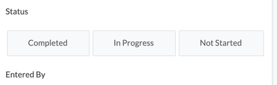

Thank you for your response, I already tried and mentioned in my original post that I used the expression SORT(LookupTable[ColumnC]) but it is not working i dont know why. I can see it works in test view but in the app view its not, please find the snapshot below of test view, my expression and app view
So just to be clear, you are pulling values from another table and trying to display them in Descending order as the Status  choice list.   Correct?

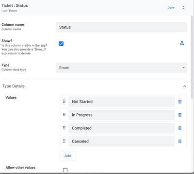

the data type of another table is "enum" and already sort the value in that table same as below screenshot

Ah, ok!  The Enum values are configured for THIS column ONLY.  They are not visible anywhere else in the app.
If you wish to reuse this list to make sure ALL your Status columns have the same list of Status values, then you would need to create a dedicated table of "Status Values" and then reference that Table in both/all of your Status  Enum columns.  I do this frequently.
The easiest thing, obviously, is to simply replicate the list of Status values in your other column.  Then you can control the order by moving the values to be listed in the order you wish them displayed. Of course this means when you need to update the list you need to do so in multiple places.
