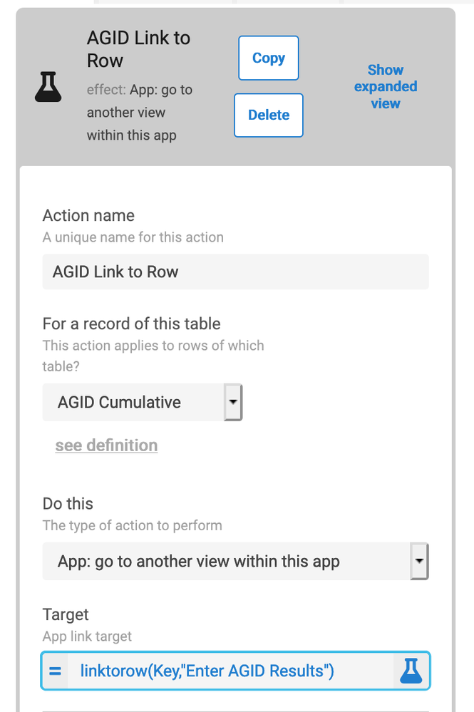

Thanks @Greenflux. Here is the Action I created and the result when I try to use the form.
You have to reference the key-column for that row. Replace the word key in LINKTOROW() with whatever you used for your key.
I named my key column Key.
You left off the [ ] square brackets.
LINKTOROW( [ Key ] , “Enter AGID Results”)
