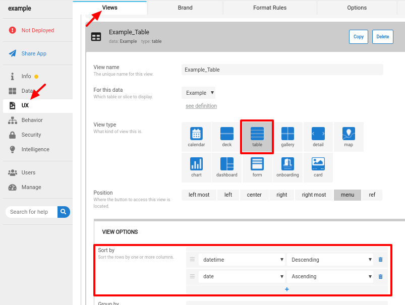

If the intent is to sort the data for display in a view (e.g., a table view), the view itself should be configured with your sorting preferences:

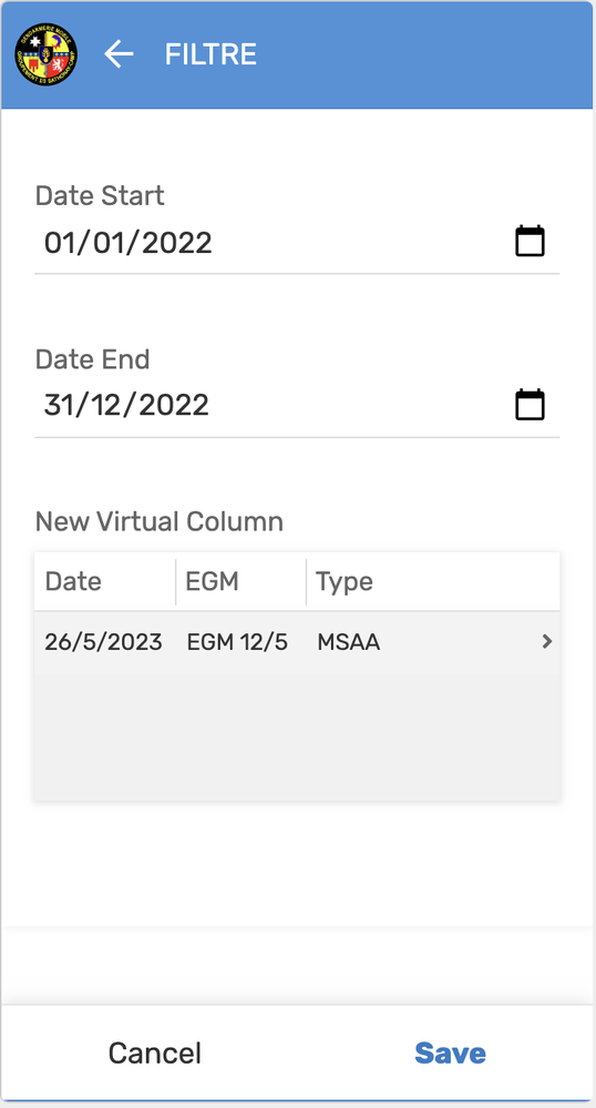

The formula is valid BUT the result is that the first date is taken into account in the sorting (Date Start) BUT the second (Date End) is not taken into account …
Watch an example from my screenshot.
I put in Date End 12/31/2022 but look I have a result in 2023 …Someone else ?
Thanks again
Rémi.
Hmmm, how about:
FILTER("DATA", AND([Date]> [_THISROW].[Date Start], [Date]<[_THISROW].[Date End]))
thanks it works! I was wrong, I had not seen the “AND” in the formula.
the right formula is therefore:
SELECT (DATA [_ROWNUMBER], AND ([Date]> [THISROW]. [Date Start], [Date] <[ THISROW]. [Date End]))
