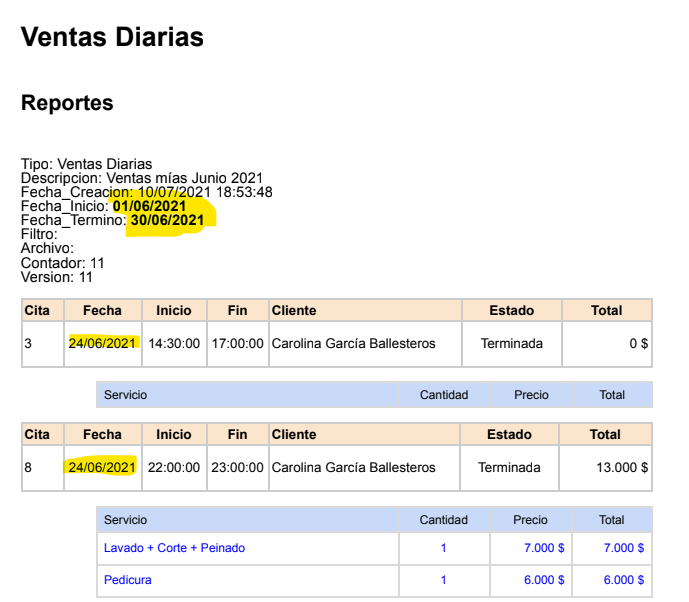

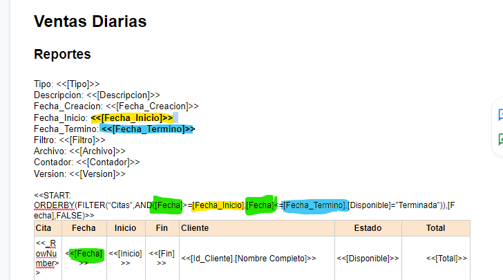

I have a very strange question about date ranges in a report. I am creating a report with the finished appointments of a company, the user can choose the date range that he wants to save in a PDF and a couple of more criteria.

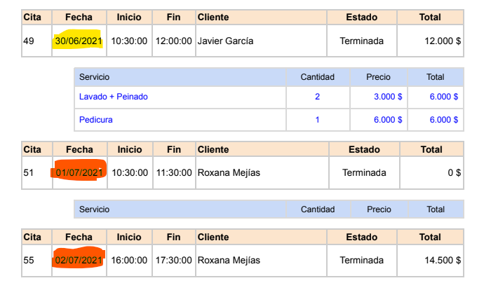

However, something is not working when I ask you to filter a range of dates (From-To). The strange thing is that the criterion โ€œFromโ€ does it correctly, but when I apply โ€œToโ€, the report does not filter and add all the records until the last recorded date of the table. Has anyone had a similar problem and solved it?

[_THISROW] is missing from your formula. You need to use [Fecha]>=[_THISROW].[Fecha_Inicio] and same for the other one.

I did what you indicated but the error persists, although the logic of the solution is correct (I tried it several times), it seems that you have to indicate with the prefix [_THISROW] of the field in the reports table for it to work. Anyway, you helped me with the conversion that I am using in other report. Thank you.
This was exactly the problem, thanks!!!
