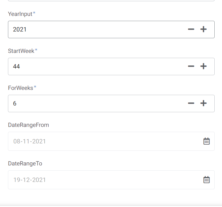

Hi @Chris_Jeal ,
Sorry, I had not tried anything till your post today, Have tried a few related expressions now. Hope it helps.
The column names and associated expressions are summarized below
One test case in test app below

Hi @Chris_Jeal
Will there be a different row for each project for each year? How are these rows created for each project for each year- meaning how a new record is inserted? Is there one column for each month in the table that depicts the Gantt chart ?
Maybe you wish to have a time window of three years on the Gantt chart so that typically projects running over a year and rollong into next calendar year could be shown comfortably instead of creating new rows for a project every year. Creation of a new row for every year and every project in the Gantt chart could in general be more complex.
The video below capture project timelines from 2020 (previous year), 2021( current year) and 2022 (next year).
When calendar year 2022 starts the timeline will automatically change to 2021, 2022, 2023.
The idea is, typically projects older than last calendar year are not likely to be active. The timeline can be made to appear only for those months where projects are active with a slice. With this slice approach, one need not show all the 36 months but only those months where projects are active.
