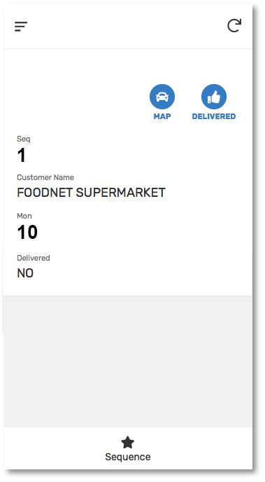

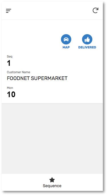

Basically the Driver App pulls data from the Admin App. Once the driver clicks the delivered action button, it saves that delivery to another table to keep track of deliveries. Below is a screenshot of the Driver App that I’m working on. It shows the sequence on the route for that store, the store name, and the delivery quantity for Monday. Once they’ve delivered to the store they click the Delivered action button and the next store in the sequence shows up in the Detail View.
