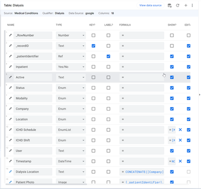

here's a glimpse at the data structure of the dialysis schedule table
Just thinking out loud but i can probably accomplish this with a LOOKUP() expression, though i am still curious if my approach of a dereference is just wrong completely.
