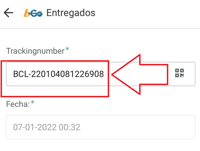

Is totally linked now BUT, the field automatically comes fill after go to the form, also it let me put another product_id <> to the previous one (that one where I came from).
The idea is that field keeps “empty” when I enter to form an scan a code (which should be the same from the details view)

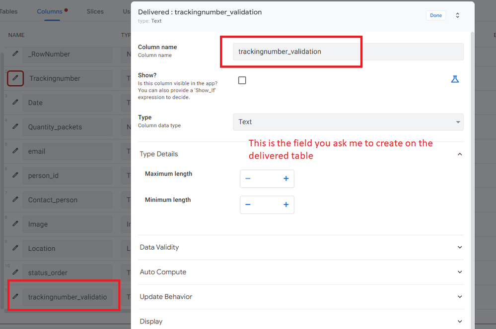

Please create another column in the table on_process called say [Product_Id_Validation] . Make this column hidden ( Show_if set to off)
From the LINKTOFORM() action, please populate [Product_Id_Validation] with the [Product_Id] from the new_buy table.

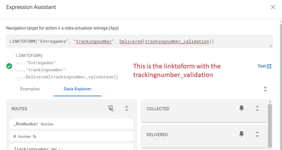

Im gonna show you the images (maybe will be confuse for you because now Im gonna show the real names of tables etc):
Hi @Tovarsho ,
Not sure what you are attempting. Could you please update what is the field Delivered[trackingnumber_validation] in the LINKTOFORM action?
I think your LINKTOFORM() be simply
LINKTOFORM(“Entregados” , “trackingnumber_validation”, [trackingnumber])
where “trackingnumber_validation” is the column in the “Entregados” form and [trackingnumber] is the column in the source table where the detail view is based on. ( new_buy)
Hi Suvrutt,
Table (new_orders), table (delivered)
In new_orders:
  • trackingnumber (field) “this one has info”
This new_orders table has the information of a buy (which has the product information, tracking number. etc)
In delivered:
  • trackingnumber (field) “this one is empty and I need to fill it trought the form”
  • trackingnumber_validation (field) “this one you ask me to create”
This lastone table has the FORM, which I need to complete, and fill the “trackingnumber” field, but this trackingnumber field SHOULD be the same trackingnumber when I came from the detail_view from the new_orders information.

Please create
  1. LINKTOFORM(“Entregados”, “trackingnumber_validation”, [trackingnumber] )
  2. In the valid_if of [trackingnumber] in the delivered table , please have [trackingnumber_validation]
I did it exactly as you ask, but got error, I think because the field is text?
What is the TrackingNumber_Validation column type?
valid_if needs to be
[_THIS] = [trackingnumber_validation]
Is TEXT, just the same as trackingnumber field
Okay yes, please use Marc’s suggestion. Thank you Marc.
