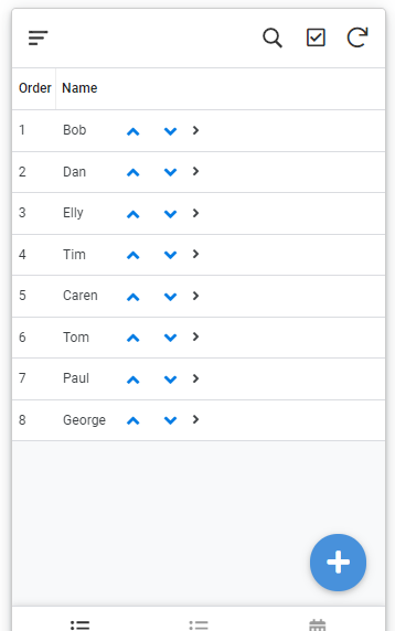

I am trying to make it possible to order some values dynamically.
I have a row with some names and their sequence (order) in a list, see below (f.e. in a competition where people are frequently having a certain particular position, that might change over time).
What I want to achieve is when I manually click on the up-arrow, the row should move up - when I manually click on the down-arrow the row should move down within the list. So the order no should change within the row i click on and within the row above/below.
I was thinking of having kind of virtual row with the related rows and take this way influence on the order within the related view, but do not know how to achieve it.
Does anybody has an idea what the expression should look like?
Also would be great to be able to type in the new order no into a row, that the currect row with the same number gets a lower order no and all the rows beneath automatically sortet one row down (closing the gap of the order no, where the moved up row was taken away).
Thank you much for your help!

Iโ€™m not sure whether there is a beautiful solution for it, but the first thing that comes to my mind is:
Letโ€™s imagine I have a table called โ€œProduction cycleโ€. In my case everything is ordered by SEQUENCE NO column.
  1. Create an action โ€œChange order: Sequence - 1โ€
  2. Create an action โ€œChange order: Sequence + 1โ€
  3. Create an action โ€œChange order: Set sequence of previous + 1โ€
    Referenced rows formula: SELECT(Production cycle[CYCLE ID], [SEQUENCE NO] = [_THISROW].[SEQUENCE NO]-1)
  4. Create an action โ€œChange order: Move upโ€
    This is the parent action that triggers the reordering process.
5,6,7,8. (The same logic is for the โ€œMove Downโ€ action)
You can use a method described here to trigger the action or:
  1. Go to Data -> Columns and a virtual column for your table called โ€œAction buttonsโ€
  2. Go to the โ€œChange order: Move upโ€ action and change the appearance to:

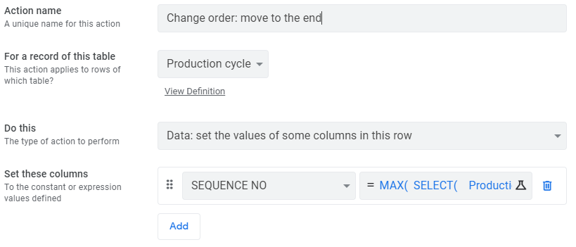

Hmโ€ฆ I already deleted this functionality from my app, so I canโ€™t test it. But, I think we can do something like:
Create an action โ€œChange order: resetโ€
Using this action the sequence number will be set to an empty value
In the formula for SEQUENCE NUMBER just write empty brackets like this ""
Then another action โ€œChange order: move to the endโ€
MAX( SELECT( Production cycle[SEQUENCE NO], [category column] = [_THISROW].[category column] ) )+1
Then, we create a Workflow:
Update event: โ€œUPDATES_ONLYโ€
โ€œIf this is trueโ€ formula:
[_THISROW_BEFORE].[category column] <> [_THISROW_AFTER].[category column]
In โ€œDo thisโ€ block, we trigger the following actions:
  1. Change order: reset
  2. Change order: move to the end
In theory it should work.
