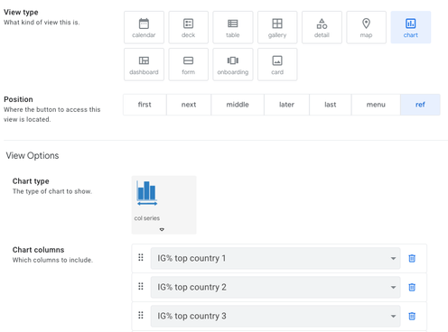

I've created a chart view that is filtered only on the selected row with the columns Top 1%, Top 2%, Top 3% with a col series chart type.
By default, the display name of each entry is the column name (so "Top 1%" etc). What I want to achive is to change the display name of "Top 1%" to the actual value of "Top 1" (e.g. "USA").

This is the Appsheet view settings:
The chart displays correctly, but the display name is the column name:

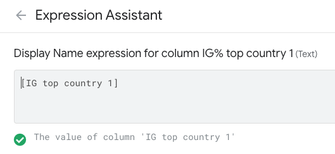

However, the display name of each column is set to show the respective value of the neighboring label columns, e.g.:
The test functionality in the expression assistant also shows that the returned value is correct,
but it won't show in the chart itself. When I set the display name to a fixed value, e.g. "Test ABC", it does:
My question is how to achive that the actual value is being displayed, so [IG top country 1] ?

Alternatively, as display name I also tried
[_THISROW].[IG top country 1]
which leads to the same result (expression assistant marks it as correct, the test table returns the correct values, but it doesn't show in the chart).
