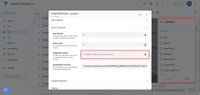

I have a many rows each with repeating and non repeating values for the field LOCATION,
I offer it to search, but the search list itself needs to be sorted, My formula placed here didnt work. Any insights would be great.

Try SORT([Location],FALSE) - https://support.google.com/appsheet/answer/10107698?hl=en

Your formula gives error
So [Location] is an ENUM.  Whereas SORT() is expecting a LIST type column as the first option.  To make it not error then this will work:
SORT(LIST([Location]),FALSE)

Thanks for that, but the actual problem was to sort a filtered list rather getting the right syntax of SORT. It makes sense to sort the LIST instead of ENUM.
I did as you suggested, but still no luck

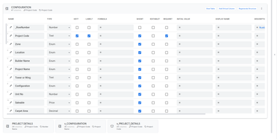

Thanks Joesph, Yes thats enum, here are the screenshots
