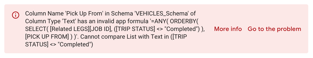

Hey Steve,
Thanks again for taking the time to help.
Here is the error message:
Column Name โ€˜Pick Up Fromโ€™ in Schema โ€˜VEHICLES_Schemaโ€™ of Column Type โ€˜Refโ€™ has an invalid app formula โ€˜=ANY( ORDERBY( SELECT( [Related LEGS][JOB ID], ([TRIP STATUS] <> โ€œCompletedโ€) ), [PICK UP FROM] ) )โ€™. Cannot compare List with Text in ([TRIP STATUS] <> โ€œCompletedโ€)
and the screenshot:
I quickly mocked up this diagram/table to show how I currently have this setup (Hopefully, this is enough information)
Currently, I donโ€™t have a โ€œleg numberโ€ column, but this can be added.
The reason for this is that some deliveries are 1 leg, some are 4 legs (and everything inbetween)
This tells me the TRIP STATUS column is a list type, either EnumList or List. If so, 1) why???; and 2) replace ([TRIP STATUS] <> "Completed") with NOT(IN("Completed", [TRIP STATUS])).
