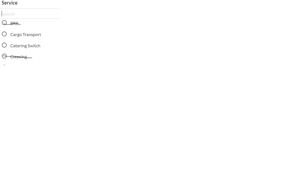

in a table called service I have a drop-down menu that takes data from another table ref. (TEST)
how can I not see the services I have already added?
THANK YOU

I think the number 3 option is the best
I would like to do something like this in the picture

Thank you
It works perfectly !!!
