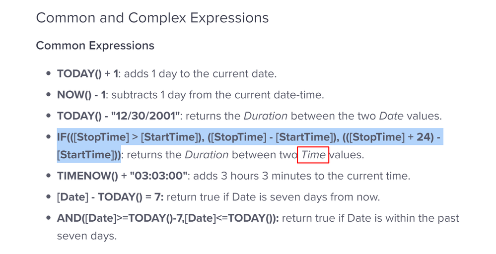

I’ve noticed that the formula given to calculate the difference between two time values in the documentation doesn’t work great when trying to calculate the duration of someones sleep (for example).
Here’s the formula:
IF(([StopTime] > [StartTime]), ([StopTime] - [StartTime]), (([StopTime] + 24) - [StartTime]))
When the [Start Time] = “13:00:00” and [End Time] = “15:00:00” the DURATION result is correct. But when we have a [Start Time] = “22:00:00” and [End Time] = “07:00:00” the result is “-09:00:00”…
