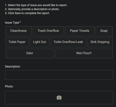

The app is launched from a URL, actually a QR code. Location is determined by the QR code, not geolocation. Think of a location as a location in the building, not a map. The Location ID must be specified in the URL to look up the Location Type (Restroom, Elevator, etc.) from the Locations table so a filtered list of Issue Types appropriate to the location can be presented to the user. This is the Issues form that should load:

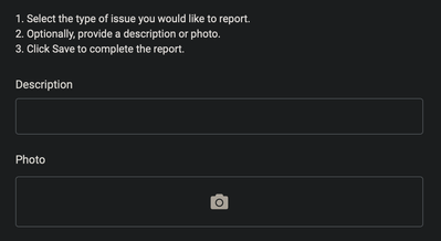

This works beautifully in all cases except one: on initial page load. The Issue Type is not displayed until the page is refreshed or until you select a different location (which wonโ€™t be allowed in the app since the report will be tied to your current location). The initial load looks like this:

@Marc_Dillon here is a test URL: https://www.appsheet.com/start/922582bb-7f00-45c7-b096-c2a266e4e6d3#control=Report&defaults=%7B%22Lo... You should see an ACCEPT screen followed by the broken form. If you refresh or change the location the buttons will appear. Thank you!
I see that you're pushing values for Building and Location Type through in the URL. But those columns have App Formulas. Maybe try to remove those and just have the Location_ID?
@Marc_Dillon You are right. I should have mentioned that Location ID is the only required field and I added the others for testing only with the thought that maybe there would be fewer calculations on that initial load. The behavior is the same without those preset values. The issue still occurs when truncating the URL to Location ID only: https://www.appsheet.com/start/922582bb-7f00-45c7-b096-c2a266e4e6d3#control=Report&defaults=%7B%22Lo...
You also picked up on the unnecessary _ in Location_ID. Also a test because I read somewhere along the way not to use spaces, so I changed that one column name.
Both of your URLs appear to work fine for me at this time (I did see the described issue earlier). Did you change something?
It will always work on subsequent attempts or on location value change. Try pasting the link into a private or incognito window. This will simulate a first-time user, replay the app consent screen, then you will see the issue.
Ahh, gotcha. So it's probably not an issue with the URL then, but has to do with the interplay with the consent screen. What if you turn the consent screen off?
