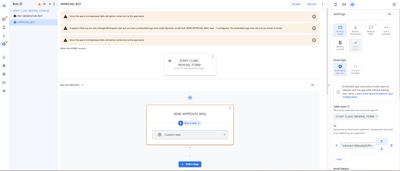

Attahced some Screenshots.
Here is how it is setup.
And i did not make any change to the app prior to the issue.

How is the process, i.e. the 'Mail' step configured? I presume you are pulling records from another table there and including it in the dynamic email? Are any of the recipient emails not GMail based? Note that your process has a specific warning about dynamic emails only working with GMail. Your error still suggests that there is no data being sent in the Email task.

Screenshot(s) of the Step showing all the settings (you may redact any sensitive information) will also be helpful to troubleshoot the issue.
Here is the Data column and the preview on the right..
