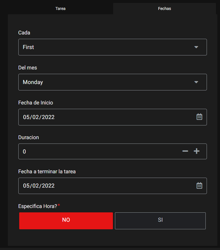

This is the screenshot of the same screen on both platforms... the end date it gives on the ipad indicates that it returns blank.

I don't know if this would solve your problem, just an observation that might help.
It is shown that the regional settings on your ipad (1st screenshot) is different from your device (2nd screenshot). The first is showing a long "dd mmmm yyyy" date format, while the second is showing an "mm/dd/yyyy" date format.
Please test changing the regional settings of your ipad to match what is configured on your other device and see the result. Thanks.
Thanks for answering. I already tried changing region, date, languages ​​etc. and the problem remains. The dates with the format that is seen in the capture in other functions have no problems. Any other suggestions?

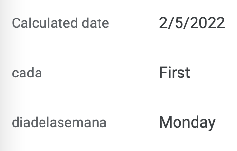

Thanks Pedro, sorry I couldn't think of anything else. FWIW, I've tested the exact expression on my iPhone, using Safari and the AppSheet app and it is giving me a correct result.
Thanks Joseph for trying to test, obviously there is something in the configuration locale/language that allows it to work, but I can't find it. I use Safari because I haven't tried it and I have the same behavior.

Hello Pedro,
I've done several additional tests and was able to reproduce the behavior. I now believe it is a bug with the implementation of this function in iOS. Also, you are right, changing phone language and regional settings do not make any difference.
The first test I've done was with calculation in a virtual column, this is the screenshot in my previous reply, and you can see it works correctly.
Today I've tested again but with a normal column and the date didn't get calculated correctly.
I went back to testing with a virtual column and looked closely, I saw that once the form is saved, the field in the table view showed "invalid date" immediately after the save, but after few seconds, when the app has synced the new row with the server, this field changed to display the correct calculated date.
So I concluded that EXTRACTDATES() was able to understand your English phrase when launched on the server, but not when launched on the local iphone device.
To confirm my conclusion, I switched back to a normal column, and did the test below. The test was successful and you might use it as a workaround
Workaround: remove the expression from the App Formula, and instead put it in a data change action to change the value of this column, then launch this action from a Bot that monitors addition or updates of your table's rows.
It is worth noting that when you launch this action through a button click, you get invalid dates and you get a message indicating that the action has failed. However, when launched through a bot, it performs and completes successfully. Therefore I could confirm my conclusion.
