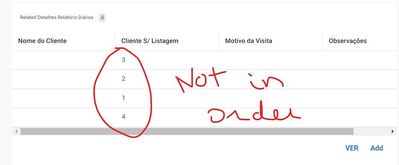

I have a referenced table where people register their daily work. For example, if they visit one client, they fill the information, then they go visiting another client and so on.
The thing is that, when they send their daily work, the email that I get is not in order of their visits.
In this example as you can see, the numbers are not in order. Maybe one way of doing that is to create a new column and as they fill the information, it will increment the number and then filter by this column? Hope you can understand it. thank you.

You can customize the table-type view that is used for the table you note. One available property is sort order. The view is likely named something like Detalhes Relatorio Diarios_Inline.
I'm aware of this option, but I don't know how I can "tell" the system what was the order that someone placed the information. For example, I cannot sort the information by the name of the client. I want to sort by the people/client they visited first.
It was better like this to understand? Thank you.
If your need is not to sort by the [Cliente S/Listagem] column noted in your screenshot, then I don't understand what you're trying to accomplish.
No matter what, if the data you need to sort by is not in your table, then you won't be able to sort based on that data.
That said, maybe sorting by the [_ROWNUMBER] column is what you need? That would sort based on the order in which the rows were created. Nonetheless, my guess is that that's the default sort order you're already seeing and isn't meeting your need.
I tried to sort by using [_ROWNUMBER] but it doesnยดt worked. Is possible to create a new column that adds automatically numbers to the data that I fill and then maybe I can sort it that way.
If I write down something that line gets the number 1, if I add another line it gets the number 2 and so on.. It's better for understand what I want to accomplish? Thanks
I'm not sure what doesn't work about [_ROWNUMBER] for your scenario, nor how it would be any different to dedicate an additional field with an incrementing number that's functionally equivalent to [_ROWNUMBER]. I suggest share screenshots or other details illustrating what you have configured that's not working as you expect.

Sort by the row number, the app sort it well, but not as I like to do it.
In this example, the first name that I choose was the client 100 Golpadas and to control what client I choose first I placed the sort number on the column [Cliente S/Listagem] (just for guidance).
The correct sort for what I want should be 1, 2, 3, 4, 5, where the row number should be like this:
3455 = 1
3456 = 2
3457 = 3
3458 = 4
3459 = 5
