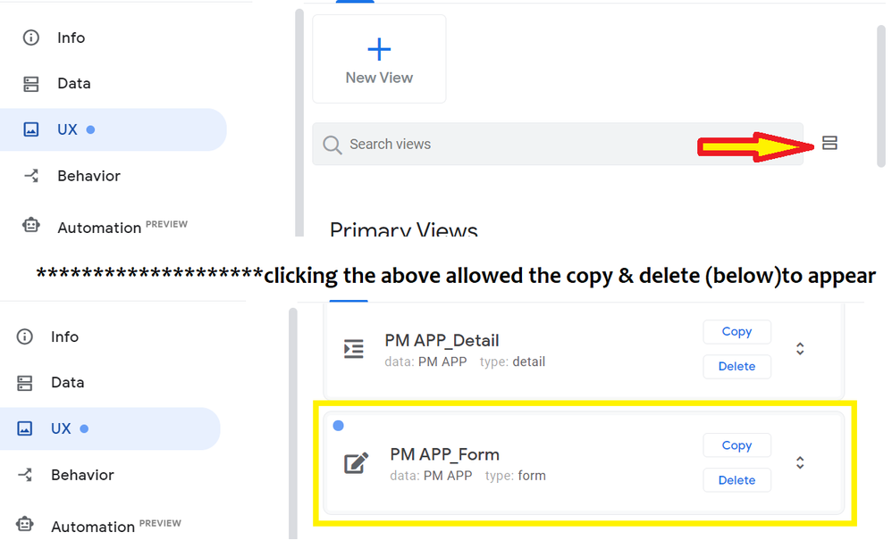

T_McG
Clicking the vertical ellipsis on the Card template in the editor did then give me the option to delete the edit (or so I thought). Once I save the app, it just returns. Am I supposed to delete the form view shown below?
The system-generated views cannot be permanently deleted. If deleted, the system will recreate them.
T_McG
ok, that makes sense.
