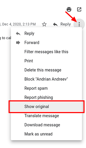

@Daisy_Ramirez : Thanks for letting me know. I’ll take a deeper look into why it is happening. Can you please paste the Show Original for the email that was delivered late? We’ll try and dig deeper. Also please indicate when it was sent so that we can compare it in the backend
Hi Sai, should I send it into support@appsheet.com?
@Daisy_Ramirez : can you please send it to saikp@google.com. I’ll take a look and get back here.

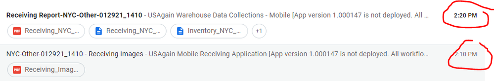

Hi Sai, just a heads up. We’re seeing the email delay again on Google Chime. The following 2 emails were generated at the same time but received 10 minutes apart.
@Daisy_Ramirez : Thanks for letting us know. Can you please tell me when the emails were generated. I’ll look in the backend to check the logs
Same client but DEV database: TST_USA_Receiving-539632
These were generated at 2:10 PM Eastern Time
@Daisy_Ramirez : Got it. I’ll take a look and let you know here. Thanks.
@Daisy_Ramirez : We have been seeing some issues in the backend which might result in some delays. We are looking into it.
Thanks Sai, will standby.

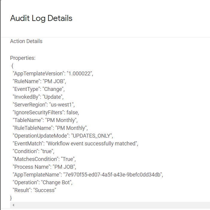

Today I was trying to figure out why my app wasn’t delivering the emails as programed to do. I launched the log analyzer and confirmed that my workflow and all actions had fired correctly. I kept trying to figure out what was wrong on my end, thinking perhaps that it had something to do with me using UTC for establishing mailing rules. However everything seemed correct and was firing no problem. However, no emails. I am trying to implement a mobile credit application app for our sales people, and it is crucial that the application gets through promptly. There can be no delays and I need it to be reliable.
Doing some digging, I came across this thread, and am thinking that perhaps this happened do to the emails being sent via the System default instead of the Mandril. The emails head out with a PDF attachment which is only 56kb. Do you think this is the issue? Is there anything I will miss out on if I set the messaging channel to system mandrill?
Please contact support@appsheet.com for help with this. Support has some access to check delivery status, I think.
I have been seeing a lot more complaints lately about the emailing service. Way more than we ever saw before hand.
It seems like there is a bug in the email feature.
When I check the trace, all the events are run successfully. But I’m not receiving any email.
