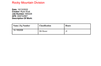

I am having trouble with a PDF attachment.  I have taken a screenshot of my template below.
If I use a bot to generate the PDF, the results are different than hitting the test button on the automation.  For the test button, the PDF looks perfect.  When I use the bot which is activated for any new entry of a table, my child record list in the chart is blank.  Below are screen shots of both the test result and the automation result

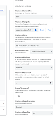

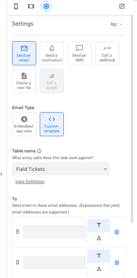

SkrOYC, I am not using "Is Part Of?".  It is currently a "shopping cart" type app, so the user starts a new Field Ticket form (the parent) then when it is saved they automatically are taken to select child records.  The child record virtual column is a list column type ref.  I have pasted below the screenshots of the actual workflow as well as the attachment settings.  Thank you very much for your help
it seems like in the test you chose a row of the parent table that has child table rows referenced.
But when it triggers automatically, the bot its running when changes affect the parent table. Not necessarily this means there are child records that reference this parent row.
So what i mean --> blanck chart = not child records referencing the parent row id.
Luis,
Thanks for the reply.  Those are screenshots of the exact same entry.  There are child records and it is not finding them if it is ran as a bot.
How?
The How just solved it for me.  Thank you, I was creating the record before the child records were in it because of the workflow.
