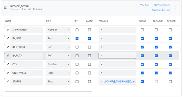

IF in your Invoice_Detail table, the column ID_Invoice is a Ref column, i.e. a pointer back to the Parent Invoice row, (by the way, if itโ€™s notโ€ฆit should be) then you can take advantage of โ€œdotโ€ notation to retrieve the status and simplify the expression like this:
[ID_Invoice].[Status] <> "valid"
It seems you have ID_Invoice as a column in both tables? LOOKUP() is expanded into an ANY(SELECT()) combination of functions. I suspect that resulting expression is then experiencing some ambiguity with same column names and not finding the correct value.
The expression above is simpler anyway.
As a side note, I found a few places where when column names are the same across related tables you run into these ambiguity problems - templates are another one of those areas. I would recommend refraining from using the same column name in these cases.

Can you show us the column definition of ID_Invoice in your Invoice_Detail table? I think there might be something not set correctly there.
Behavior definition in INVOICE_DETAIL:
And the next images are about view

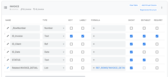

  2. Add a virtual column to the INVOICES table called Viewable INVOICE_DETAILs and an App formula expression of:
    [Related INVOICE_DETAILs]
  3. For the Viewable INVOICE_DETAILs column, set Show? to the expression:
    [INVOICE_ID].[Status] = "voided"
  4. For the Related INVOICE_DETAILs column, set Show? to the expression:
    [INVOICE_ID].[Status] = "valid"

Add button changed. But 2 column still show
Maybe this will help.
Step #5. Set the new VCโ€™s โ€œReferenced table nameโ€ to point to the new Slice.
Thank you!
I updated but nothing changed.
