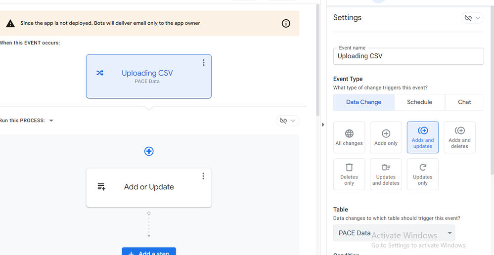

For simplicity, I wanted to add only one column for the moment till the error is cleared.
Even with adding one column I get the same error.
Please do let me know if you need more details or screenshots

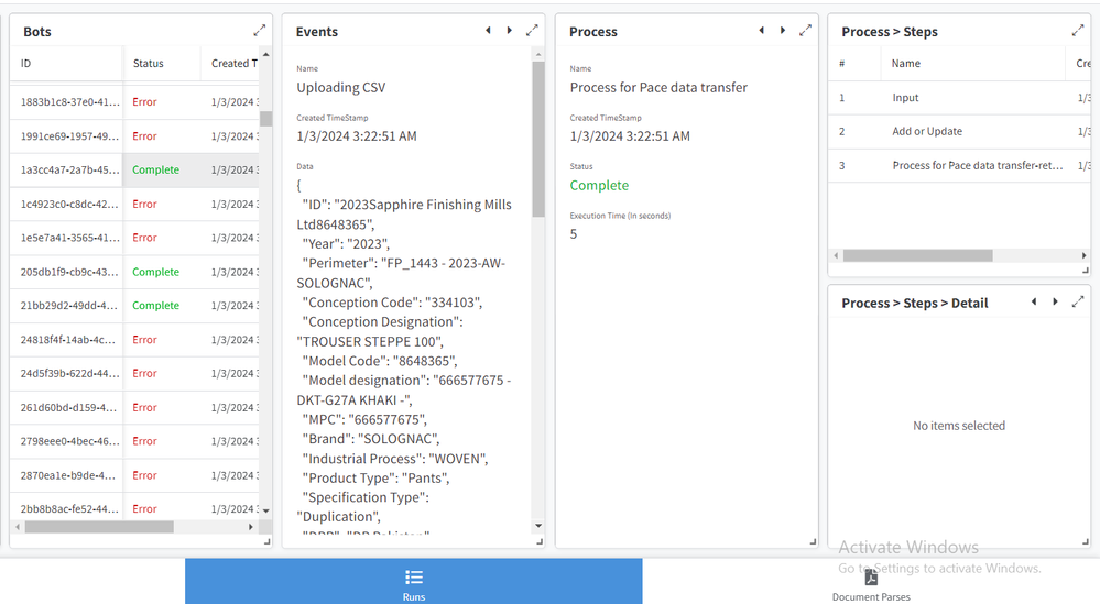

This is the error shown in automation monitor
This is who it shows when the BOT is run correctly. Seems like one step is not working
