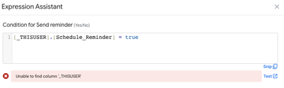

I have longstanding automations (triggered by data change events--not schedule events) that reference User Settings and continue to run successfully. Starting a couple months ago, any new automation I create where I try to include User Settings generates an error due to an invalid expression. Then, the app won't load or run at all unless I disable the automation or remove the automation's reference to User Settings. The support case I opened has yielded no resolution nor, for a long time now, even any status update.
I can replicate the error in different AppSheet accounts, and assume it affects others. Has anyone identified a way to get new references to User Settings to work?

Thanks so much for taking the time to troubleshoot the problem I'm describing. I should have explained more precisely. The scenario I'm talking about is referencing User Settings in automation steps (not the automation event). For example, the screenshots in my OP are from a Branch on a Condition step.
Oh okay, got it, thank you.
Yes, you are correct. In branching conditions in automation steps, user settings are not working.

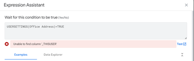

I am also experiencing this issue in other settings in automation when using user settings. For example in Wait step, one cannot use user setting.
Edit: made some changes in the post based on further testing.
