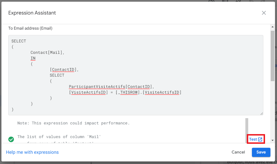

When i test my expression, it yield a list of recipient but when i run my bot i get an error "No workflow email was sent because 'To', 'CC', 'BCC' are all empty".
Here some screenshots.
I created an expression that yield a list of recipient for the current "VisiteActifs".
When i Test this expression, it seems to be ok as it yield a list of recipients.
But when i run this bot, this step of sending an email doesn't work, there is no recipients.
Do you have an idea of what is happening ?
0 5 463
What happens if you put that expression into a virtual column and then used the virtual column as the source of the email adresses?
Wow, it works now ! But i still didn't know why it didn't without a virtual column. Thank you.
