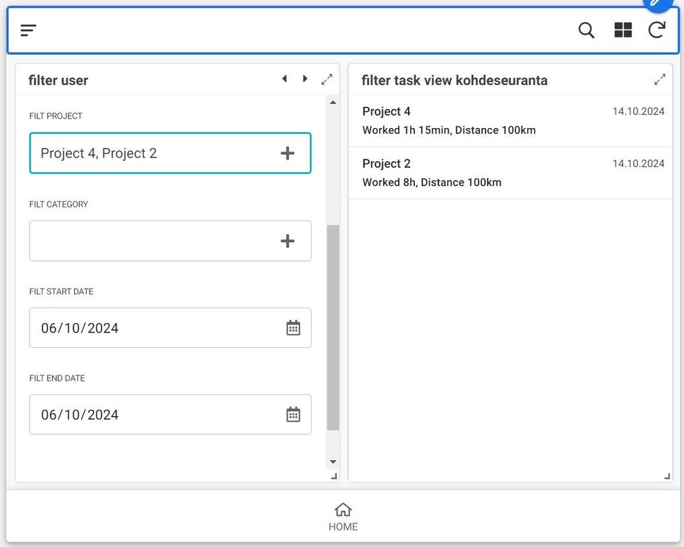

I have an dashboard view where there is a card view for quick edit boxes and dynamic view, related to what is chosen in quickedit boxes. Dynamic view use slice of an table to filter the data shown. This method is commonly used and can be found several youtube tutorials.
Below is a screenshot what the view looks like. You can have very complex scheme.
Left view is slice from usertable with search parameters, in my case project refs to third table and one or more can be chosen from EumList. Other three boxes not yet operatioinal as I started this over troubleshooting the error. Right view is the slice from another table. This same right side view can be achieved with two different expressions, but only one exports CSV correctly.

Basically yes. No matter which one of the expressions is used, view always shows everything correctly, wether it's rows for one project or several, and yes there can be several rows, ie tasks (dates) for every project.
But with SELECT as mentioned at start, if project filter is empty, according to IF statement it shows everything and print is correct. Choosing one project from list export works correctly, no matter how many rows. Choosing multiple and the view is correct and shows rows accordingly but exporting csv fails with only headers exported.
