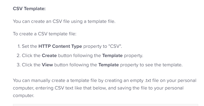

In the documentation regarding the Save File action, the documentation says to set the “HTTP Content Type Property” to “CSV”. Where exactly does this happen?
I figured out where to do this. It’s in the workflow set up.
