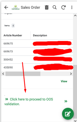

>>" to my knowledge I cannot place that action button at the bottom, requiring scrolling to see it (please correct me if I'm wrong)."
You can attach it to a column, as inline prominence. At which point the entire column value becomes clickable. Like this:
I used a format rule to color both the action and the column value green.

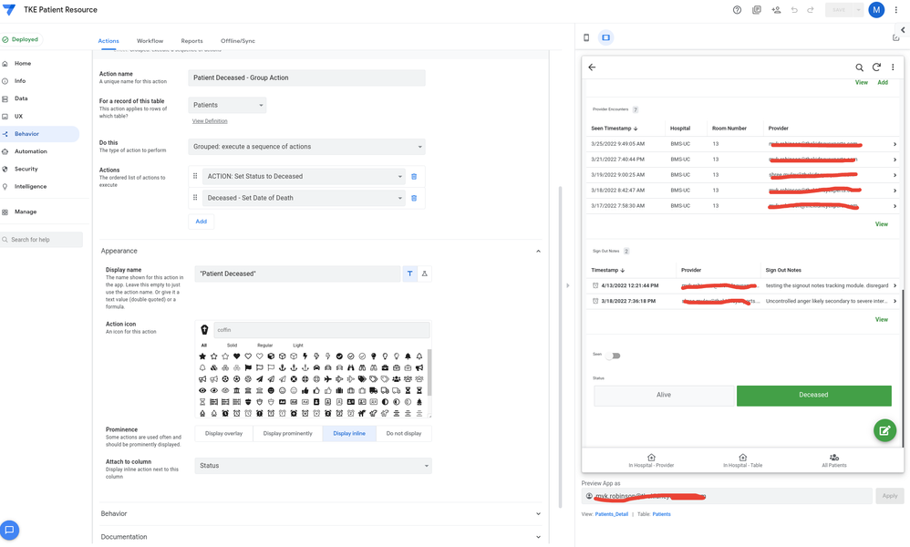

the years have been unkind to my test patient, Demi Lovato, who may or may not look a lot like me ๐Ÿ™‚ Anyways, here's how it looks with Display Prominently" set, notice the Deceased button up top:
Now, when i switch it to Inline Prominence and set it to attach to the Status column (Enum List, currently at the bottom of the view to hinder accidental clicking for the time being),  I guess I expected to see "Patient Deceased" listed somewhere around that field, but i do not see anything:
I think since your status column is a quick edit field in the detail view, the inline action is not available.
If you remove "status" column from quick edit, you should see an action icon inline of status column.

Still no luck, and I can't figure out why. Is this particular "type" of action just not usable in this method?
UPDATE: @Marc_Dillon @YogeshLaddha
I changed to the grouped action and it shows up, so it would seem that my LINKTOVIEW() based standalone action is not compatible with this method?

All the actions are compatible for inline prominence.
There are couple of reasons why it wouldn't appear next to status.
1) Below the "Appearance" section in action details, there is a behaviour section. Please check if there is any condition that might be preventing it from appearing.
2) If you have created a slice and are using it for your detail view, then you might want to check if the action you want to use is in the slice actions list.
As for formatting,
1) You can create a virtual column and in the app formula enter whatever text you want to keep.
Attach your inline action to this virtual column.
2) In the Display Name for the virtual column just put " ".
3) Use format rules to apply any color or formatting you need.
Also if you don't want to show the action icon for inline, you can just remove the icon in the action by selecting and deselecting any icon.
