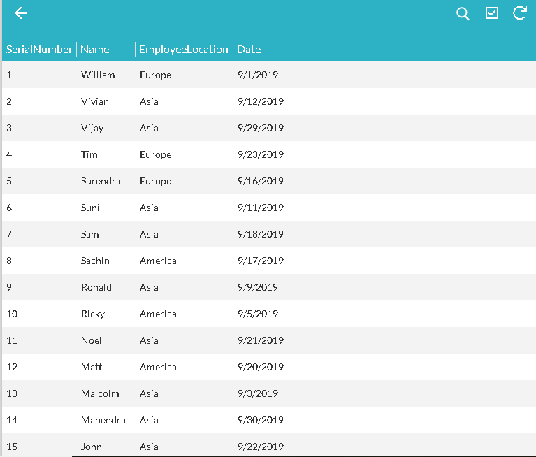

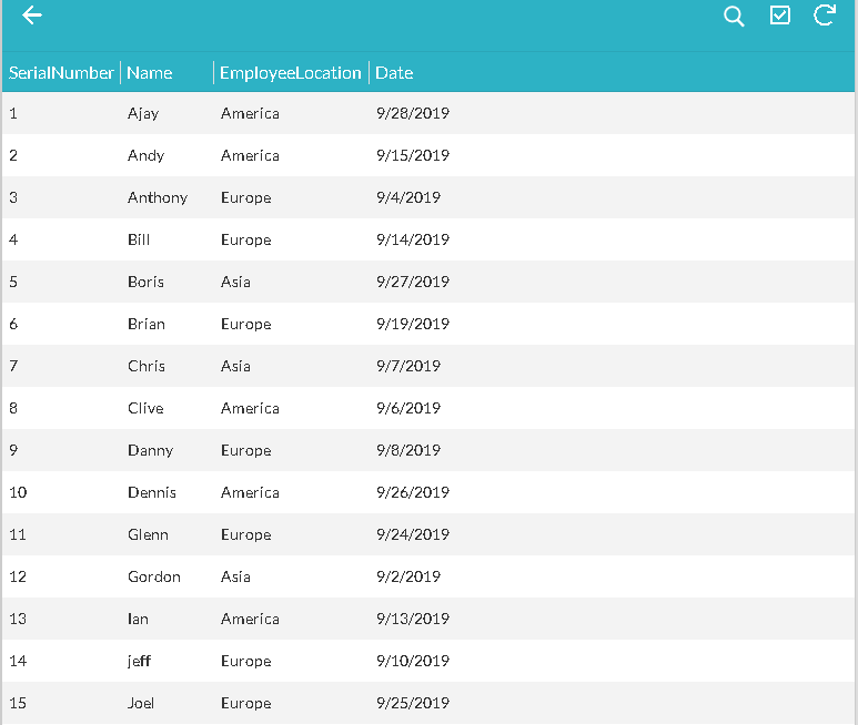

Image 1: The original list of employees.Please note that this one is ordered by employee id. The names of the employees are in random order as far as first letter of their name is concerned.
Image 2: The list in descending order by names. Please take a look at the column called Serial Number. This column has serial numbers matching the descending sort order of names.
Image 3: The list in ascending order by names. Please take a look at the column called Serial Number. This column has serial numbers matching the ascending sort order of names. Thus the serial numbers have changed to match the new ascending sort order.

Yes, the serial number is VC. I would urge you to take a look at the app. Iwouldhave liked to describe the implementation here itself. It is a bit tricky.
  1. ORDERBY column [SortEmployees] in the parent table MasterTable is carried back to the child table EmployeeList , through dereference.
2)Using this carried back dereferenced column [SortEmployees], the Serial Number VC in the EmployeeList table with an expression COUNT(SPLIT(LEFT([SortEmployees],FIND([Name],[SortEmployees])),",")) is created.
A) This expression extracts the list till the employee name in current column using LEFT([SortEmployees],FIND([Name],[SortEmployees])) and
B) then reconverts the extracted names back to list type column using SPLIT() command,
with SPLIT(LEFT([SortEmployees],FIND([Name],[SortEmployees])),",")
C) Finally this list is counted by COUNT() till current name with COUNT(SPLIT(LEFT([SortEmployees],FIND([Name],[SortEmployees])),","))
  1. Now this VC [SerialNumber] in child table gets carried back to parent table master table with reverse reference columns [Related EmployeeLists] and [SortEmployees] and now the [SerialNumber] column ia available in parent table for display.

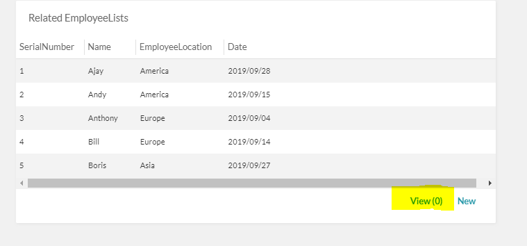

Nothing to do serialnumber virtual column, but i noticed one odd.
This could be a bug potentially? Have a look. Inline view, counter for the row is indicating nil.
Just give you head up.
Yes, I realized that. I suspect it is because of that bit of extra rotation of columns between two tables.
However on tapping on View() does take to extended list.
