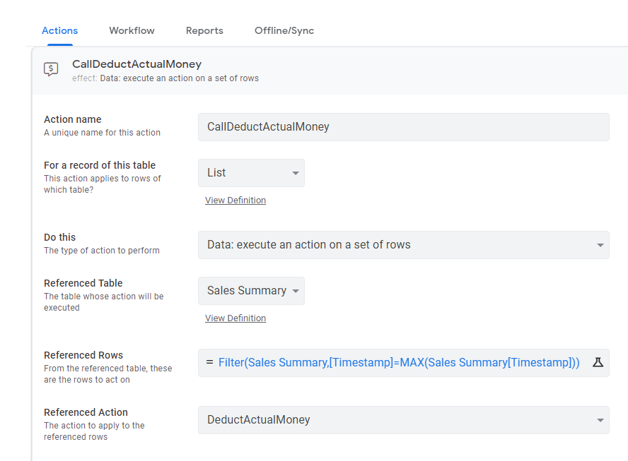

I have used this:"Filter(Sales Summary,[Timestamp]=MAX(Sales Summary[Timestamp])) " in my reference rows from my action. it is working as expected.
I have copied the same expression in a similar app and it is strangely returning list instead of one Max Value.

Could you share the screenprint of the action where you are using the expression?
here it is. thanks

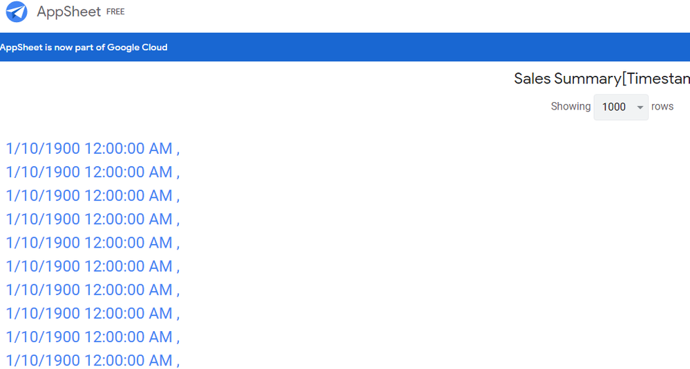

Why when I test it using Sales Summary[Timestamp] in app B, the [Timestamp] Returns these:
it became all same value

Can we just analyze rather why the result is giving all same datetime values even the gsheet stored all unique datetime values. the filter expression is giving multiple result due to gsheet is giving all same strange values or appsheet is extracting that is not present in the gsheet.
please see image;

A FILTER() expression, like this:
produces a list of key column values of rows that match the selection expression ([Timestamp]=MAX(Sales Summary[Timestamp])).
The result in the first app you referenced:
is a list containing only one item, the key column value (fcdf1c07) of the one row of the Sales Summary table that matches the selection expression. That this list contains only one item means there is only one row in the table that has the maximum Timestamp column value.
In the second app you referenced, the same expression produced a list with multiple entries:
This indicates that each of the rows having the listed key column values have the same Timestamp column value, and that value is the maximum value. This is reinforced by this later screenshot from the second app:
All of the displayed Timestamp values are identical. If I asked you to identify which one row from among those with that Timestamp value was the maximum, which would you choose?

As I pointed out, I looked at the gsheet and found out that the timestamp column has all unique real datetime values and for some strange reason when I run the expression it picked up multiple same max values which it should have not been since there is really only one max timestamp value.
