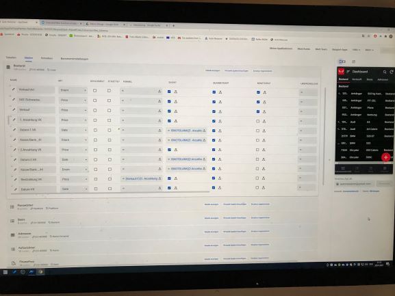

sorry for my imprecise language. Unfortunately my application is very extensive with a lot of columns, tables, and data. It would be unbelievable with screenshots. Therefore I try to describe and hope for your understanding. The google translation doesn’t make it clearer.
The filter has an ENUM with the values ​​"still to be processed" and monthly billing "(with which I would like to distinguish the source and source2)
and are located in the “Filters” table.
also “filter start” and “filter end” and “results”, “results” is column type type “list” and element type “REF” with which I access the table “inventory”. All data that are filtered are in the table “Inventory”.
“Inventory” has “Source” and “Source2” and different date columns for payments made. both “sources” are enums with the value “other” and “dealership”. The structure is in the table the source then down payments and final payments, everything for purchasing a car. In the sales area of ​​the car again source2 and down payments and final payment. I would like to achieve this with the filter. (Filter all data records which have the sources “Other” and any date is in the range of the filter date). Or!! (I filter all data records which have the sources “car dealership” and any date in the range of the filter date). I want to make my billing easier at the end of the month, so just find all vehicles that have any payment date in the month.
