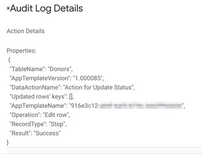

Thanks. I look at the automation monitor and the audit log. There was an error with a required column that wasn't a part of the payload. I fixed it and now it works partially.
The bot is supposed to change the status column for the newly created record, and then send an email. I've now managed to make it send the email, but it still doesn't update the status column, even though it marks the operation as success in the audit log.
I expect it to select the row that was just added, and update only its status column. Later on, I'd create an expression to update status based on the information from the other columns in the row, but I'm first trying to just make it work with a static text string.

If the Status column is from the Form, I wonder whether there's a conflict between data from the Forms app and changes to that data from AppSheet. Consider reviewing the cell's edit history to see whether maybe AppSheet indeed revised the value but then Forms reverted it.
