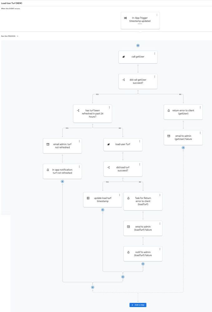

Here's what the bot looks like. It's supposed to do this:
1. An app user clicks a button which calls a task that updates a timestamp on the user record.
2. This triggers a call to an AppsScript called 'getUser', which sends an API call to Salesforce to return a User record that matches the logged-in app user's email.
3. If getUser is successful, the bot then calls a second AppsScript called 'loadUserTurf', which sends a second API call to Salesforce to retrieve a list of contacts that belong to the logged in user.

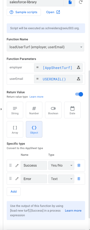

So for example the loadTurf step (which calls the loadTurf AppsScript) looks like this
and then I am checking for Success = TRUE in the next step in the process. But it's not returning the actual sheet data (contact records) to the bot.

As far as I know, return values from a Call a script step you have access to are the ones you specifically return from your function using a return statement.
Your function is "directly" updating the spreadsheet (not using Appsheet API) and the bot does not know the data used to write the row.
If you want to use the data, apparently retrieved from Salesforce in your Apps Script, in the next step of the bot, you have to explicitly return it from your script.

@scott192 @TeeSee1 thank you for your responses. I am only using the bot for client-side error handling. So the only things I am trying to consume from the API calls sent by the script are a boolean 'Success' value and a string for an Error if one exists -- all the actual row data returned by the API is being written to the Google sheet programmatically by the script. I am explicitly returning the Success and Error values from the script, as you can see in the second screenshot in the initial post.
Also for the first two months after I built this app, the 'Success' and 'Error' values were being successfully returned. There seems to be some kind of new bug in the way the Success and Error keys are being returned and consumed by AppSheet, and I was trying to figure out what was causing that, or if there's a way to control how those values are returned so that AppSheet can successfully convert them.
