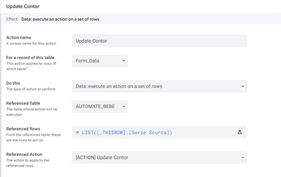

Here is my action:
I'm not sure what is happening, but suddenly the app is not finding the data from the spreadsheet, I feel like that is causing the errors, since the ref rows are empty, so the value is null.
I'll double check this and see if it fixes my problem.

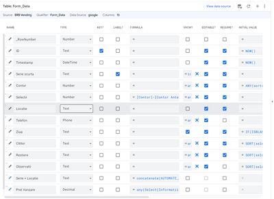

[Serie Scurta] inside [AUTOMATE_BEBE] is this one:
This one also has a formula for "Suggested values" to return data only for the currently selected day in the form
So, the [Serie Scurta] column is key in both, though from what I know it shouldn't be inside the form as well, since a specific key can exist more than once and that is not allowed.

This is what I have:
- a form, table called "Form_Data" that stores all the data submitted via the form
- a table that needs to update based on the data submitted using the above form
The main part of these is the [Serie Scurta] column which is basically a Serial Number which I wanted to use as a common factor between the tables so everything updates where that specific value is found.
[Serie Scurta] IS marked as Key in the main table [AUTOMATE_BEBE], but not in the form [Form_Data].
My question is - can the key in the form table contain duplicate values? since the table will store multiple times a specific key value. From what I read the key needs to be unique.
In your action, the [_THISROW] keyword is referring to the Form_Data table, so when you use this expression: "LIST([_THISROW].[Serie Scurta])"   you are simply creating a LIST of that text value - it is not a list of reference values.
The Referenced Rows property needs to be given a LIST of row reference values (i.e. row keys) from the REFERENCED TABLE table.  In your case, because [Serie Scurta] column is the key column of the Referenced Table "AUTOMATE_BEBE",  that expression needs to be:
SELECT(AUTOMATE_BEBE[Serie Scurta],[Serie Scurta] = [_THISROW].[Serie Scurta])
or you can simplify it like this:
FILTER("AUTOMATE_BEBE", [Serie Scurta] = [_THISROW].[Serie Scurta])
 I hope this helps!

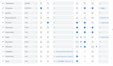

I'm not sure why this "LIST([_THISROW].[Serie Scurta])" won't work, I am using the same logic that I have here:
Devices Data:
Show More
The equivalent to [AUTOMATE_BEBE] from the app I am working on right now
Proces Verbal:
Show More
The equivalent of [Form_Data] from the app I am working on right now
The form Proces Verbal is updating the values in Devices Data.
