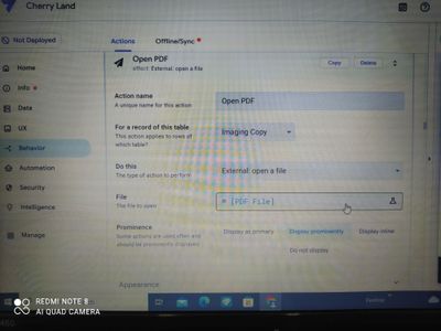

To open the file, I make a action external open a file.
This error is not only on this table but also on another tables that create like the automation and action to open the file.
I'm sure the URL point to a pdf file.
The left day it's Ok open the file of another tables.
This error happened to open any file.
Please let me know what happened.

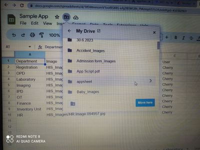

My main gsheet is in gdrive.
The main gsheet is Sample App.
You can see it in photo.
That printscreen shows that this file is in your gDrive, but it doesn't show in which subfolder that file is.
Do you see IC Files and it's path?
Appsheet - Data - NeoApp-4381282
I am facing this issue for every folders in this photo.
No, it's not shown here. For example open the gSheet and go to Upper left menu > Files > Move. It shows you in which subfolder it is.
โ€ƒit is my gsheet.
You need to click the "Move" to see what is the subfolder name.. and then you can click the arrow in the upper left corner where that subfolder is and so on.. to the Root.
So.. if this printscreen is from that popup right after you clicked "Move", the gSheet seems to be in your Root. Is my assumption correct?
Yes.
Correct.

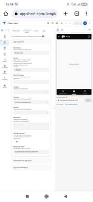

App default folder is correct.
App formula is correct.
Generated pdf file is exit in default folder.
But file is not found.

My action is to open the file.โ€ƒ
I think my expression and action are correct. Not just open this file.
