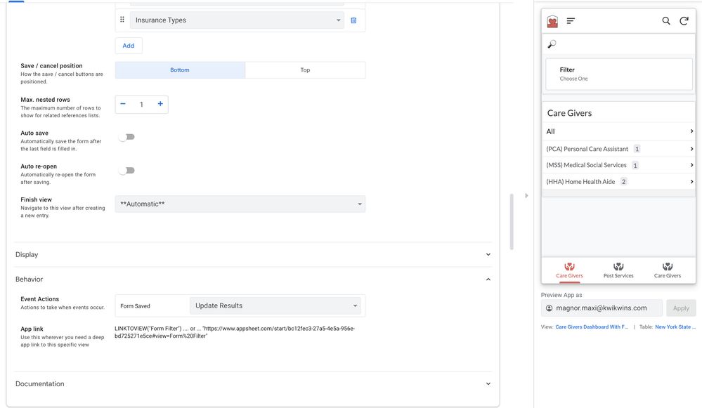

Table 1’s Actions is mainly to save each unique filter as a new row in form, but at the same time once entry is submitted to open a filtered view, hence why i used this formula once form is saved
Action : Go to another view in app
Target:
LINKTOFILTEREDVIEW(“Care Givers Deck”, AND([Main Service Offering] = [_THISROW].[Service Types], [languages] = [_THISROW].[languages]))

What steps are you doing in the app leading up to the failure?
Screenshots are best.
Dashboard is a front end view for users
you can see the section above is a button that opens up the “Filter Form”
The section below is the deck
Steps leading to failure
Once form is submitted the screen should return back to the dashboard with the new filtered results

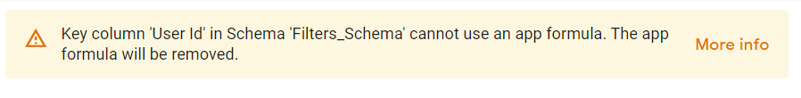

1.3 Shall the User Id have the UNIQUEID() in Formula. This is what you mean Each User will get their own row" …
to be continued…
Nope, use USEREMAIL() or CONTEXT("Device"). Put the expression in Initial value`, not App formula.

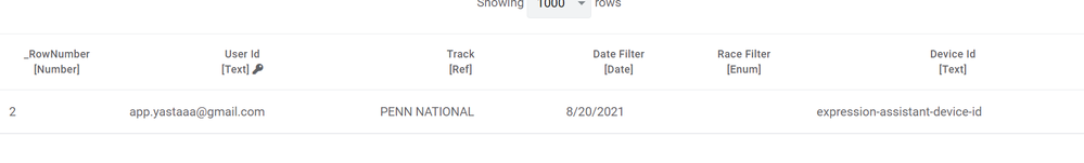

I tried with CONTEXT(“Device”) and didn’t work. Maybe because the Filter table is empty now. First i have one row with apps email.
I can’t find my device UUID.
Populate a column with the output of CONTEXT("Device").
This is what it shows using a virtual column and the formulae.
Create this simple filter and doen’t work.
Interactive mode in the Dashboard is Active. Change the Track for One withot Records (Rows) and nothing happened.

But is not working with the Date. MAybe is because the Date is in numbers, and i cannot get rid of the warning symbol.
This expression is invalid:

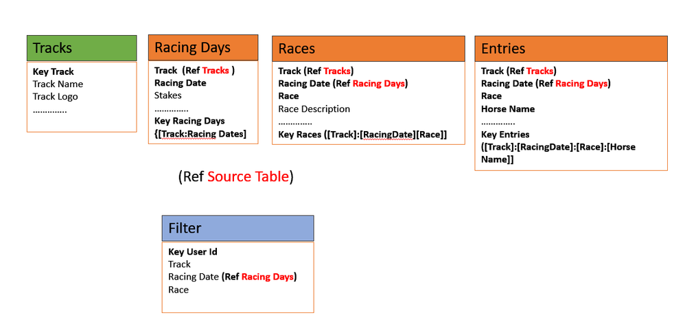

The warning symbol was solved Referencing Racing Date in Filter to Racing Days Table. This is the Table structure.
But now i cannot filter by date because when i select the date the table Filter Fills with this (the key):
