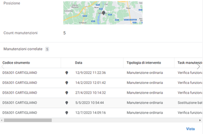

I have this table with referenced records (first row has 5 ref records):
Heres the detail of the first row:
What I want to to do is filter the rows from the first table based on the ref records in the detail. Specifically I want to show the record only if one of the ref records was made in a date time [Timestep]>TODAY()-n since I'm creating a dashboard in wich I want to show only records made too often in a precise timestep.
