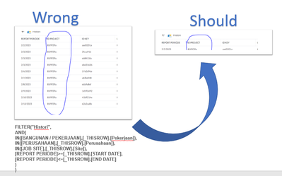

what i want is [Id Project] to show only one or last one
someone can help me for what formula i need to add

i want to display some data, according to my selected criteria.
but for [id project] it only appears once, because this is the identity (unique) of each job

This Is a mock-up
I want to make filtering data, with some of the same data.
I do filtering with the formula:
FILTER("Histori",
AND(
IN([BANGUNAN / PEKERJAAN],[_THISROW].[Pekerjaan]),
IN([PERUSAHAAN],[_THISROW].[Perusahaan]),
IN([JOB SITE],[_THISROW].[Site]),
[REPORT PERIODE]>=[_THISROW].[START DATE],
[REPORT PERIODE]<=[_THISROW].[END DATE]
However, there is still a duplicate of the same item [ID PROJECT] ,
What formula should I add so that [ID PROJECT] appears only 1x or MAX ...
previously I made in Slice with the formula max
[_THISROW]=MAXROW(
"My Table",
"_ROWNUMBER",
([_THISROW].[ID PROJECT] = [ID PROJECT])
it does get the value from last, but it doesn't work well with my filtering which has a date range :
