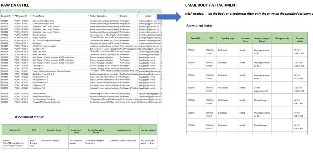

The โ€œStart:โ€ statement within your template table has a FILTER() function but itโ€™s not filtering anything. The second value of โ€œTRUEโ€ in the function is basically saying that ALL rows should be included.
We need to know how your automation has been implemented. Since you are sending a โ€œweekly email reportโ€, Iโ€™ll assume you are using a Scheduled automation bot. Is this running โ€œFor each row in the tableโ€ or not?
For your filtering, its not clear to me how you get from your shown data to the statement above. That might partly be due to the text is cutoff on the right-hand side of the included image. Also, is the example Assessment Status a bad example or the expected result?

<<Start: ORDERBY(Filter(โ€œP3 Demandsโ€, (USEREMAIL() = [Initiator])), true)>><<[Demand ID]>>
Update: Been able to filter per Useremail() from the Initiator column
<<Start: (Filter(โ€œP3 Demandsโ€, ([Initiator] = USEREMAIL())), true)>><<[Demand ID]>>
But the notif workflow only works when we click the โ€œTestโ€ icon, it returns blank on the โ€œRunโ€ and on the scheduled reporting.

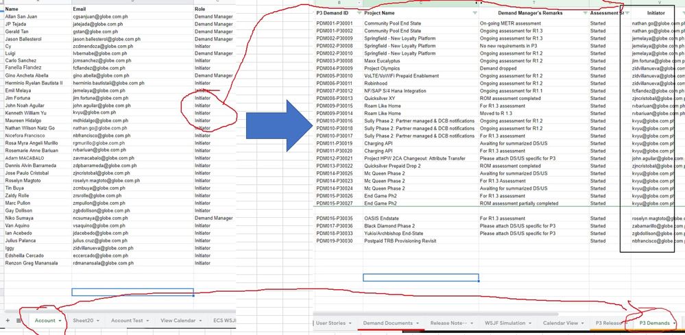

Are u refering to this tab โ€œAccountโ€ as shown below? this is actually used for User account management and Yes, the Email from โ€œInitiatorโ€ column here are the one who do the actual entry to have data on the โ€œP3 demandโ€ sheet.
We are thinking to have a slice for each row,
e.g. 30 rows or 30 initiators = 30 slice but this is not ideal especially if we try to add more users in the future.

Yes!! This is perfect and should be the table you use to identify WHO gets the emails.
I would recommend a bot that runs against your Account table. The Filter Condition for the bot would be:
AND(
         [Role] = "Initiator",
         IN([Email], SELECT(P3 Demands[Initiator], [Updated Date] > TODAY() -7, TRUE)
The above expression will filter the Account user rows to those Initiators that had made an update over the past week. (I think thatโ€™s what you wanted - updates over last week). The โ€œForEachRowInTableโ€ switch will then send each Account row - i.e. each Initiator row who had changes the past week - to the rest of your bot that generates the email.
In your email template, you can now adjust the report table START expression to this (not certain which date column to use but you can adjust as needed):
<<Start: FILTER(โ€œP3 Demandsโ€,
                           AND(
                                    [Initiator] = [_THISROW].[Email],
                                    [Updated Date] > TODAY() - 7
               )>><<[Demand ID]>>
Note that any reference to [_THISROW] will refer to the Account row that is passed to the template.

We tested this one and still received an unfiltered table, you may see the first column.
Start expression looks good. To help further we need to see 2 things:
  1. How the bot event is configured.
  2. Examples of the raw data you are expecting to show up on the report.
