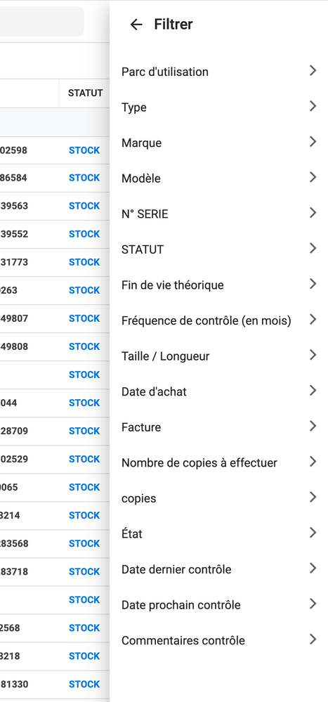

I have several tables with slices with all or part of the data depending on the establishments and users of each establishment.
However, when a slice with a limited number of data is in a view and users want to filter the view, users have in the filtering options all the values ​​of the table and not only that of the slice.
How to avoid this? This damages the experience and is a major security problem if you have personal information that should not be accessible in other establishments
Thank you for helping me !

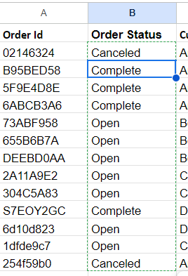

I believe the default filter includes all the options that have been saved in the backend table for that view.
So for example, if there is a [Status] column and it has three values, "Open", "Complete" and "Canceled" saved in the backend table, then the filter will present all those three options irrespective of if the slice contains records with only status as 'Open"
There are some other limitations of the default filter such as the app creator cannot set the order of the options, so if the 'Status] column is saved in order "Complete", "Open", "Canceled" at the backend , the filter will show options in that order.
If the order of the saved records is changed, the options in the filter also change as shown below
