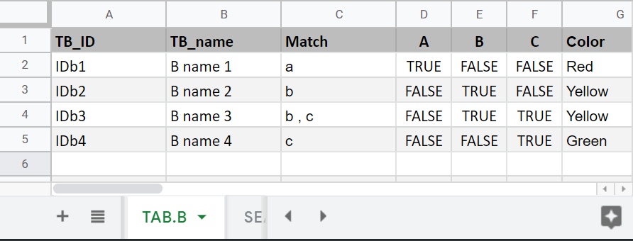

TAB.A dataset
and TAB.B dataset,
SEARCH dataset is the tab for search records.

So Iโ€™m using two Virtual Column:
in TAB.A [TA MATCH]= [Match] text format
in TAB.B [TB MATCH]= [Match] text format
in SEARCH a VC for obtain a list of matching COUNT TB_ID MATCH TA_ID
= COUNT(INTERSECT(SPLIT(TAB.A[TA MATCH], โ€œ,โ€), SPLIT(TAB.B[TB MATCH], โ€œ,โ€)))
Without SPLIT I miss some matching with multi values (a, b, c) but in anyway seems is not COUNT the single values
Then in SEARCH[TB_ID] ref to TAB.B Iโ€™d like to obtain the list of TB_ID matching all TA_ID Iโ€™m trying a simple Valid If constrict:
=SELECT(TAB.B[TB_ID], INTERSECT(TAB.A[TA MATCH], TAB.B[TB MATCH]))
Doesnโ€™t work. Any suggestions?

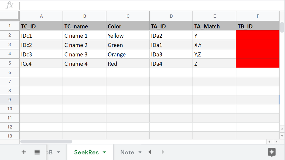

Iโ€™m trying to workout an expression โ€œValid Ifโ€ able to find the records in TabB matching any values in column [Match] with the [TA_ID] selected first.
No that was because I clone the second TAB from the first.
EnumList (X,Y,Z) text format
Iโ€™ve changed all name avoiding special characters and variable โ€œambiguousโ€ names.

Thank you. Could you please repost photos of test data and tables so that we could look into expressions with new table names?
Hi @Stefano_Martella
If I have understood your requirement , as per the new table set up please try an expression like something below in the Valid_if of [TB_ID] column in SEARCH table
SELECT(TabB[TB_ID], COUNT(INTERSECT ([TA_ID].[TA_Match], [TB_Match]))>0)
Here [TA_Match], [TB_Match] are Enumlist columns in TabA and TabB respectively.

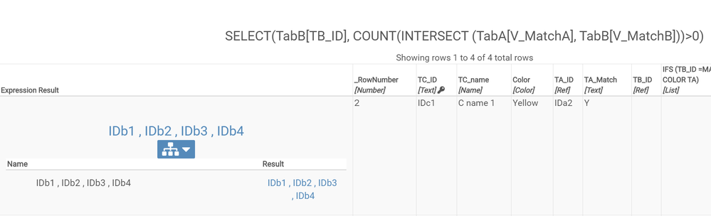

Hi tried both but this is the error: INTERSECT takes two arguments of type List.
So I try with 2 Virtual Column in text format and the expression is:
SELECT(TabB[TB_ID], COUNT(INTERSECT (TabA[V_MatchA], TabB[V_MatchB]))>0)
This syntax works but the result is all values [TA_ID]
Please make [TA_MAtch] in SeekRes table as Enumlist type column, with expression as
[TA_ID].[Match]
Please retest with the expression I shared earlier.
SELECT(TabB[TB_ID], COUNT(INTERSECT ([_THISROW].[TA_Match], [Match]))>0)
OR
SELECT(TabB[TB_ID], COUNT(INTERSECT ([TA_Match], [Match]))>0)
Edit: the above expressions did not work earlier, because you had [TA_Match] column as text type. I presumed like other 2 tables, you must have kept it Enumlist. When you posted picture of expression , I realized you had kept it text type and hence suggested to change it to Enumlist.
Also expression given by you, even though syntactically correct, I believe it will not work because you are first creating list of [Match] values across all rows and then comparing it.
The correct need is to compare at each row level.
