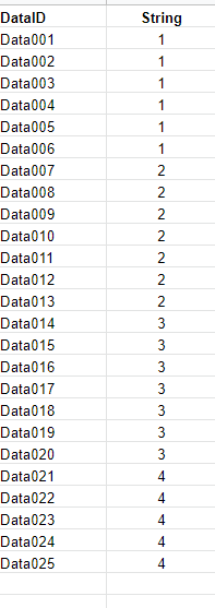

I have a column called [DataID] that references a table called “Data”. I have the label of data set to a column called [String] which has duplicate values in multiple rows, but mean different things. How can I filter the key values showing labels to be unqiue? I only want to display unique values from that column, but other rows have the same [String] value. So instead of that ref column showing five “1” values, I’d like it to only show one. How can I do this?

DataID is my key, and String is the label. I have a ref to DataID in another table. Is there a valid if constraint that only displays values in the dropdown with the condition that the string column value is unique? So that I only get one 1, and two 2’s?

The Key is fine. I have it setup so that when a key is selected, the string field is populated. The only issue is how many key values are visible with duplicate string values.
