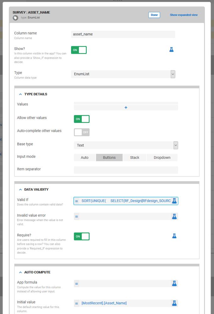

Oops… You’re right… [Asset_Name] is EnumList
Hi @Aleksi,
I don’t know if this will help… This is what [asset_name] Valid If does:
SORT(UNIQUE(
SELECT(RF_Design[RFdesign_SOURCE_Asset_Name],
AND([_THISROW].[Select_Asset_Type]=[RFdesign_SOURCE_Asset_Type], [RFdesign_Main_Asset] = [_THISROW].[Select_Cabinet_To_Survey])) +
  SELECT(RF_Design[RFdesign_DESTINATION_Asset_Name],
  AND([_THISROW].[Select_Asset_Type]=[RFdesign_DESTINATION_Asset_Type], [RFdesign_Main_Asset] = [_THISROW].[Select_Cabinet_To_Survey]))), FALSE)
