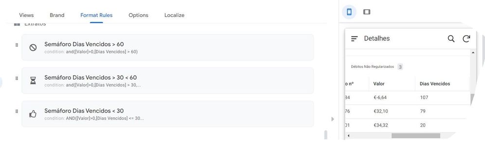

I'm trying to format rules in an inline table view, but apparently I'm doing something wrong.
The point here is that on each row of the table it display colours based on conditions. In this example on the first row it should do nothing, on the second row it should change the colour to red and the third row should be green.
Am I doing something wrong? Thank you.

In each format rule, confirm you selected the column(s) (e.g., [Dรญas Vencidos]) whose values you want the format applied to.
I think that what it's happening is that if the first row have some kind of format, that other rows follow the same formatting:
In this last example, if [Dias Vencidos] is > 30 it shoul mark as yellow, but if [Dias Vencidos]<30 it should be green

I've tested the things you said but it still not works. I also change the way of evaluating if the condition is true or false by adding a Green, Yellow or Red, but it still not works.
It only works if the table only have 1 row. If it have more than one, the formatting used on the first row will be used on the next ones.green.jpg
Any other clue?
Not really.
One more detail you could confirm is that the columns you're comparing are the appropriate data type.
