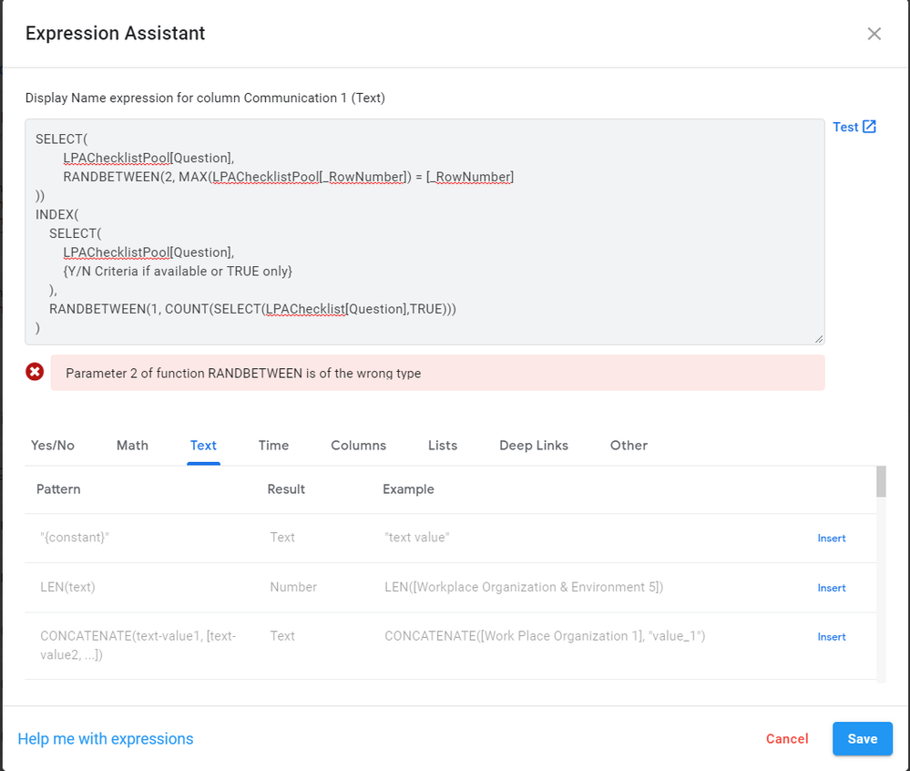

ANY(
    SELECT(
        QuestionTable[QuetionColumn],
        RANDBETWEEN(2, MAX(QuestionTable[_RowNumber])) = [_RowNumber]
INDEX(
    SELECT(
        QuestionTable[QuestionColumn],
        {Y/N Criteria if availabel or TRUE only}
    RANDBETWEEN(1, COUNT(SELECT(QuestionTable[QuestionColumn],TRUE)))
The first method gives me a "Parameter 2 of function RANDBETWEEN is of the wrong type.
The second one says SELECT has invalid inputs
Writing it all as 1 formula, I get Parameter 2 of function RANDBETWEEN is of the wrong type
@Work_Goscinski
It’s my bad…I believe there might be missing paranthesises…For the first one, try with this:
ANY(
    SELECT(
How have you constructed the second one? Can you post a screenshot?
Does the 2nd one go underneath the first?
I am not sure if this is all 1 large formula or 2 different ones.
@Work_Goscinski
I have proposed 2 different options for you. Both provide the similar result.

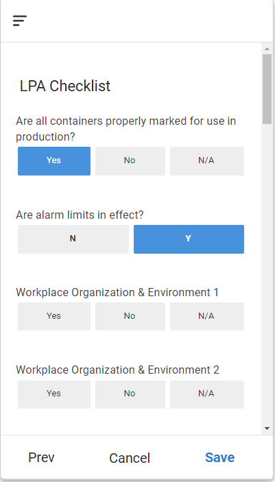

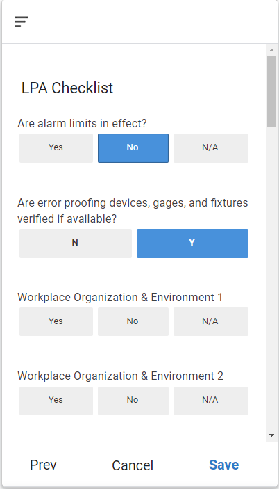

I understand now. The first one works. I put the formula in Display Name and Description.
However, when I click Y or N, the question changes. Even if I click the 2nd question.
I will try the 2nd solution.
You need to use either the Display Name or Description, not both of’em.
If I do it as display name, the question does not display.
All I did was click on No under the first question. The questions changed.
