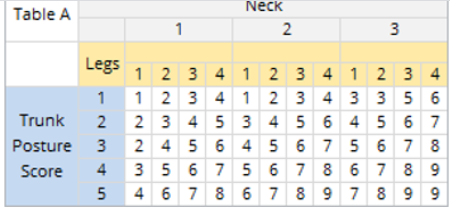

Hi, I am looking for the best way to write the formula for the attached tables.
Table A, I will already have Neck Score, Leg Score and Trunk Posture Score.
Table C, I will have Score A and Score B.
Would I be correct in writing a formula like this for Table A?
IFS(
AND(CONTAINS([Neck Score], โ€œ1โ€),IN([Leg Score], โ€œ1โ€, IN([Trunk Posture Score], โ€œ1โ€)),1,
AND(CONTAINS([Neck Score], โ€œ1โ€),IN([Leg Score], โ€œ1โ€, IN([Trunk Posture Score], โ€œ2โ€)),2,
AND(CONTAINS([Neck Score], โ€œ1โ€),IN([Leg Score], โ€œ1โ€, IN([Trunk Posture Score], โ€œ3โ€)),2,
AND(CONTAINS([Neck Score], โ€œ1โ€),IN([Leg Score], โ€œ1โ€, IN([Trunk Posture Score], โ€œ4โ€)),3,
AND(CONTAINS([Neck Score], โ€œ1โ€),IN([Leg Score], โ€œ1โ€, IN([Trunk Posture Score], โ€œ5โ€)),4,
etc etcโ€ฆ
Just making sure I am not creating more work than is required and wondered if there was an easier way?
Thanks in advance, your ideas and input is always appreciated.

I have the data for Neck Score, Leg Score and Trunk Posture Score, I need to create a formula which will allow me to get the Table A Scoreโ€ฆI thought the formula above would do it, but it doesnt. So I wanted to find out the best way to do it.

@Steve sorry, I think I have confused the scenario. I know that I cant construct a table. I am trying to construct a formula to give me the table score based on the user input.
[Neck Score] (Type: Number)
[Leg Score] (Type: Number)
[Trunk Score Posture Score] (Type: Number)
[Table A Score] (Type Number: I am trying to construct a formula based on the values shown in the table. I dont want a table I just want the number)
Example:
User inputs:
[Neck Score] (1)
[Leg Score] (1)
[Trunk Score Posture Score] (1)
[Table A Score] (Would generate 1, If [Neck Score] = 1, and [Leg Score] = 1, and [Trunk Posture Score] = 1 then it can only be 1โ€ฆ
Does this make sense now?

You need to create the spreadsheet asโ€ฆ
Then you can read the Score like
ANY(SELECT(TableA[Score],
AND(
[NECK]=[_THISROW].[NECK],
[LEGS]=[_THISROW].[LEG],
[TPS]=[_THISROW].[TPS])

The formula would obvioulsly go in the App Formula of Table A Score, but the table would be in a different worksheet? How do I get the App Formula to recognize the table?
@Aleksi I have set up Tables in my spreadsheet as per above.
I added the spreadsheet with the table to the app as read-only.
I amended the column names in the formula to correlate with the Table, then inserted the formula in the Score Column. The Expression Assistant didnโ€™t show any errors.
But it doesnt seem to be pulling the data and creating the Score.
You should have that formula in table B. Then you should have columns Neck, Legs and TPS in this Table B so you could read the value from the Score column in Table A.
Not sure I follow that .
If you are collecting data with the TableB and you want to save the score in that TableB, you need to calculate it in TableB. Iโ€™m assuming that your TableA is a read only table just for reference so you can calculate the score value when Neck, Legs and TPS values are filled in TableB.
Thats correct, thats what I have done.
But it doesnโ€™t seem to work. The field that represents [Table A Score] which has the formula isnโ€™t showing in the app.

Tryโ€ฆ
ANY(SELECT(Table A[Posture Score A],
AND(
[Neck Score]=[_THISROW].[Neck Score],
[Leg Score]=[_THISROW].[Leg Score],
[Trunk Posture Score]=[_THISROW].[Trunk Score])
@Aleksi, I must sayโ€ฆ you are an absolute legend!!! Thank you as always. It seems to be picking up the data as requested.
