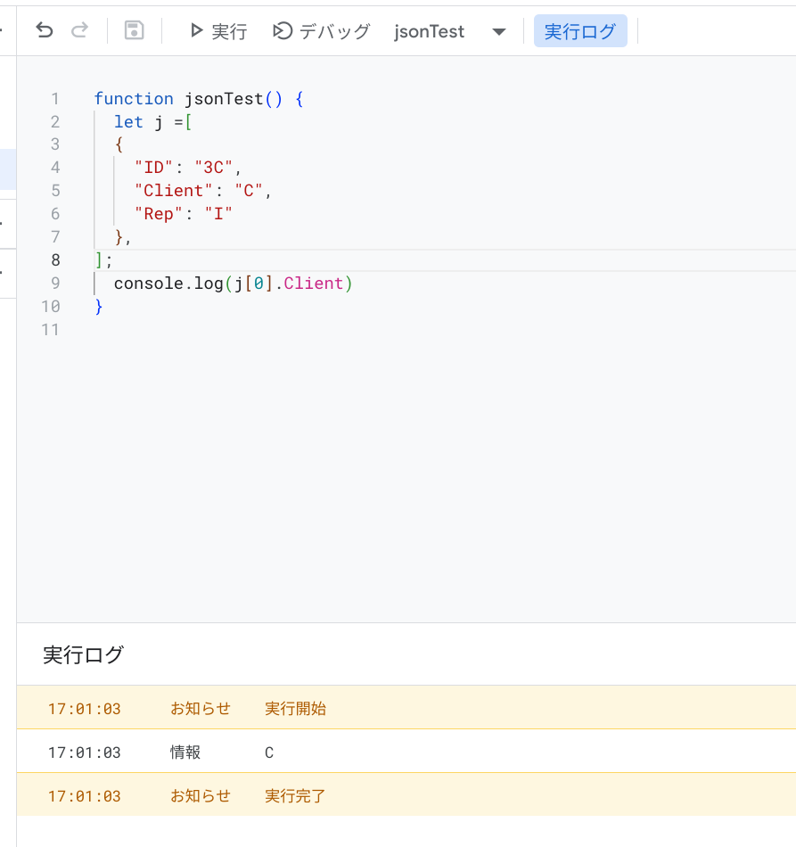

Thanks for your response.
While this would work if there are multiple Reps , wouldn't it be invalid if there is only one Rep as the example in above table  FILTER("Table1", [Rep] = "I")
Generating a JSON file shouldn't be structured correctly out of the box ?
I fail to see where it might be incorrect in having one Json object in an array. Whatever application that processes an array of JSON objects should be able to handle one regardless of the number of objects contained in it, even zero objects.
Please correct me if i am wrong.
your suggestion has a "," before the <<END>>  which is my concern
If let's say its a Single object output , wouldn't the "," before the "]"  make the JSON invalid due to line 6 having a ","?
    "ID": "3C",
    "Client": "C",
    "Rep": "I"
 Double output, same at line 11, the extra ",":

TeeSee1_1-1713340881579.pngAbsolutely no issues!
