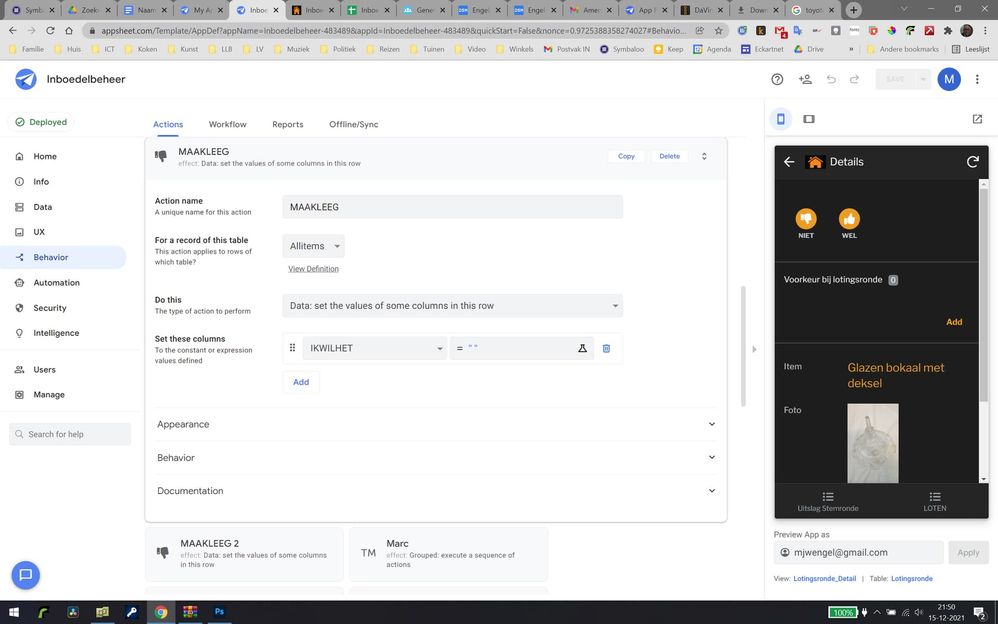

The change to the Item record is a column I added, saying ‘I Want it’ (IKWILHET in Dutch). I thought that was needed.
Screenshot
The next step is to copy this value
Screenshot 2 has to come in a second reply, and next one in a third, because the Interface tells me:“Sorry, new users can only put one embedded media item in a post.”
Because the UNIQUEID is provided now, the other columns take from this referenced column the values I want, for instance the name of the item and its number (the Table will be more ‘readable’ in spreadsheet for me)
I originally thought that clearing to orginal value was needed, so I made the action for it
But I think, judging from your comment: “I think they should all be able to do the lottery without anything having to be cleared.” that emptying is not necessary.
About preventing duplicates, what I see is that only ONE record is created for the one user. Only datetime, ‘vote’ and Lot number’ (LOTNR) are updates, overwritten, so that Ia cannot see which was the first time and number. That way any one of the heirs can kewep trying to reach higher number.
What I thought was, that making the column LOTNR Valid_IF FALSE a second time would be impossible, but in fact it is not.
The last sentences, the ones you are not following, are about the same question, really, namely HOW do I prevent an heir to vote twice and HOW do I enable a different one to cast his own vote (in a different row, of course)
second screenshot
Third one, after 8 seconds (“You’re replying a bit too quickly. Please wait a few seconds before trying again.”)

I tried it out. Made an action from within the Allitems table that will ‘add a record to other table’, being the related LOTINGs table. It seems to work in so far as placing the item number and name and adding a random number (I chose between 1 and 1000)
But the condition does not work. I presume that’s my own fault. I worked with your suggestion and although the formula seems correct, the result is not what I had hoped for. It is still possible for a user to vote multiple times, because the Action button Thumbs down does not dissappear
Question is: What did I do wrong??
I don’t understand. These brackets around [User ] are meant for columns, aren’t they???. There is no column with that name. I thought this part of the expression was for ‘calling’ the user and useremail that was logged in.
It should tell the app something like: 'Listen who is logged in, see if there is NO row for this item in the Table called LOTING and only then show the action.’
Or something similar… forgive me for my inexperience in writing these codes, I hope you understand what I am trying to say
The Thumbs down (also thumbs up, as soon as I have the correct expression) should NOT appear and instead someone should see the related table below with name and lottery number.
Solved it!!! Sorry, an old man like me needs time to think. Of course by ‘person’ you meant a field inside the LOTING table. Only problem was, I did not call it Person, but USEREMAIL. Immediately after saving this new condition to my app, the Thumbs Up and Down dissappeared in case there had been a vote.
